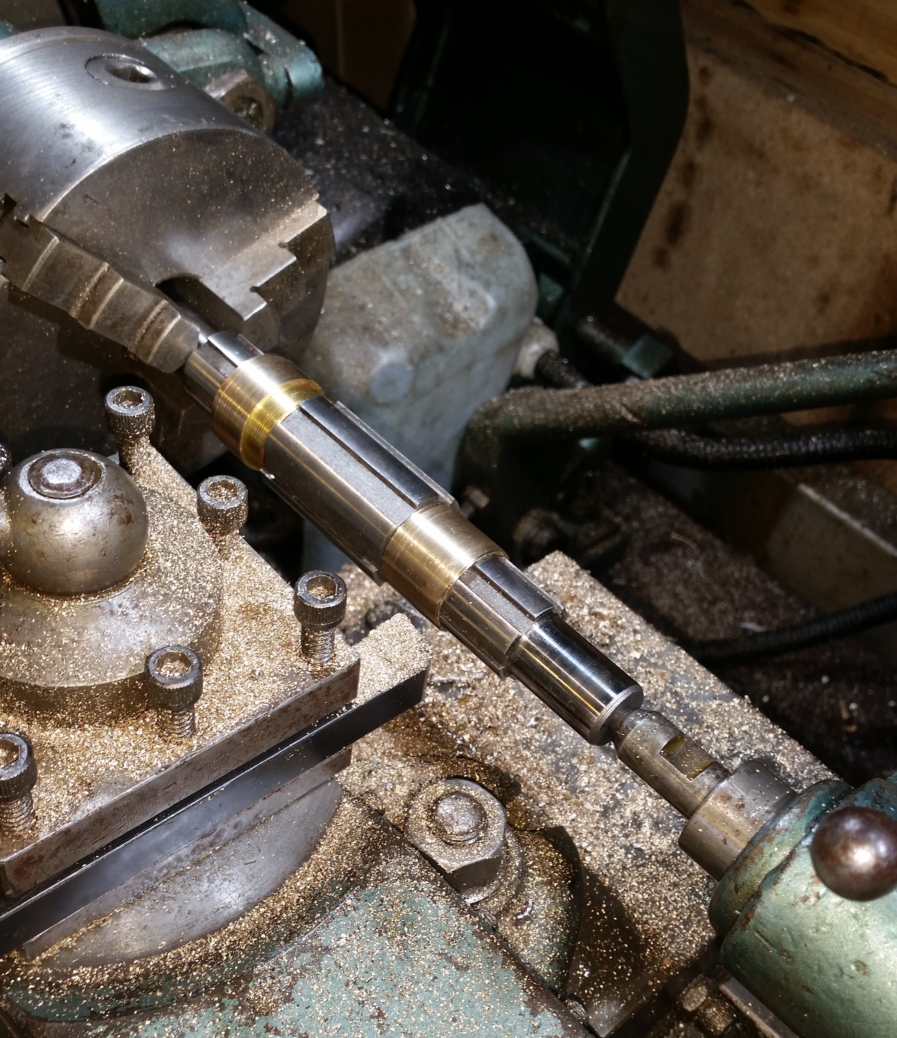

When under load 2nd gear in my CP gearbox has become embarrassingly whiny (to the extent that a rider behind me commented on it). On disassembly I found the 2nd gear cog to be very slack on the lay-shaft...
...and the teeth on the lay-shaft cog and on the main-shaft sliding gear badly worn.
Clearly I need to replace the bronze bushes on the layshaft, the layshaft 2nd gear and main shaft sliding gear but can anybody suggest a cause of this type of wear i.e. did worn bronze bushes cause the tooth damage or did something damage the teeth that caused the wear on the bronze bushes.
The first gear is worn similarly albeit not so severely but the 3rd gear and output gears appear fine.
Any thoughts welcome. Pete

I wouldn't normally worry about a bit of a whine from a 75 year gearbox but this one has got past that stage. When crawling up a gravelly 1-in-5 windy back lane I would describe the sound more like wailing Banshee than a gentle whine.
Since it is mostly 2nd, and to a lesser degree 1st, gear that is noisy, I was wondering if the worn bushes allowed the layshaft gears to wobble and increase the wear on the teeth. Either way I think I need to quieten it down a bit.
Today I made some new layshaft bushes and will now go on the hunt for some less worn cogs. Pete
