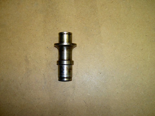

Hi Roger, have you got a picture of how the short spindle should look? Regards Kevin

Hi Kevin,
Yes, here you are.
Roger
spindle for rear sprocket

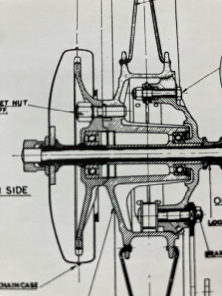

Sorry to resurrect an old thread, though to be honest it is extremely useful, so coming to the top of the pile isn't a bad thing I think. I am rebuilding the wheels on the Arrow, and re-assembling the bearings/spacers etc. I had misunderstood about the short tube in the sprocket, but just twigged when I looked at Fig 93 in the factory manual, the large flange sticks out to the nearside. The only question I have, is do I just press the sprocket bearing in until it is flush? The hole for it is twice the thickness of the bearing!

Hmm, looking again at the factory picture, I think I was too hasty in my assumption, it actually it goes in all the way, I was imagining that it faced the other way.
