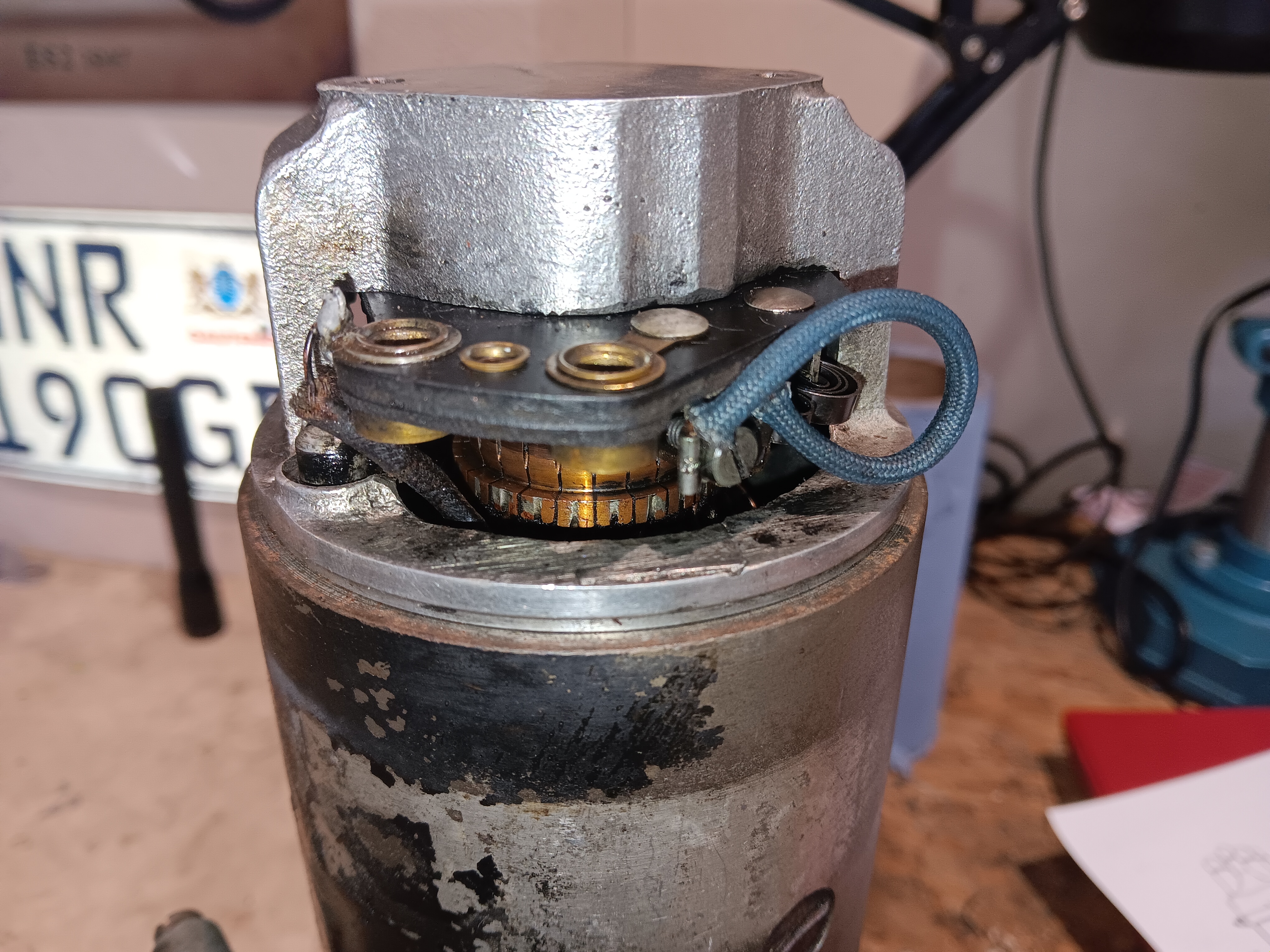

You say that the dynamo is putting out a few volts, where did you measure this?
In order to test the dynamo properly, it must be disconnected from the regulator.
Remove the rear end cover, then disconnect the two wires. See my previous post. Insulate the two wires to avoid shorting them.
Connect the dynamo terminals together with a link wire, as shown in the picture. Connect your voltmeter between this link wire and the body of the dynamo. Start the engine and slowly raise the engine speed. The meter should show a reading around 1 volt which ramps up rapidly as the engine speed increases. If you get 10 volts or more at a fast idle the dynamo is working. Do not go above 12 volts because the old field coils may be damaged.

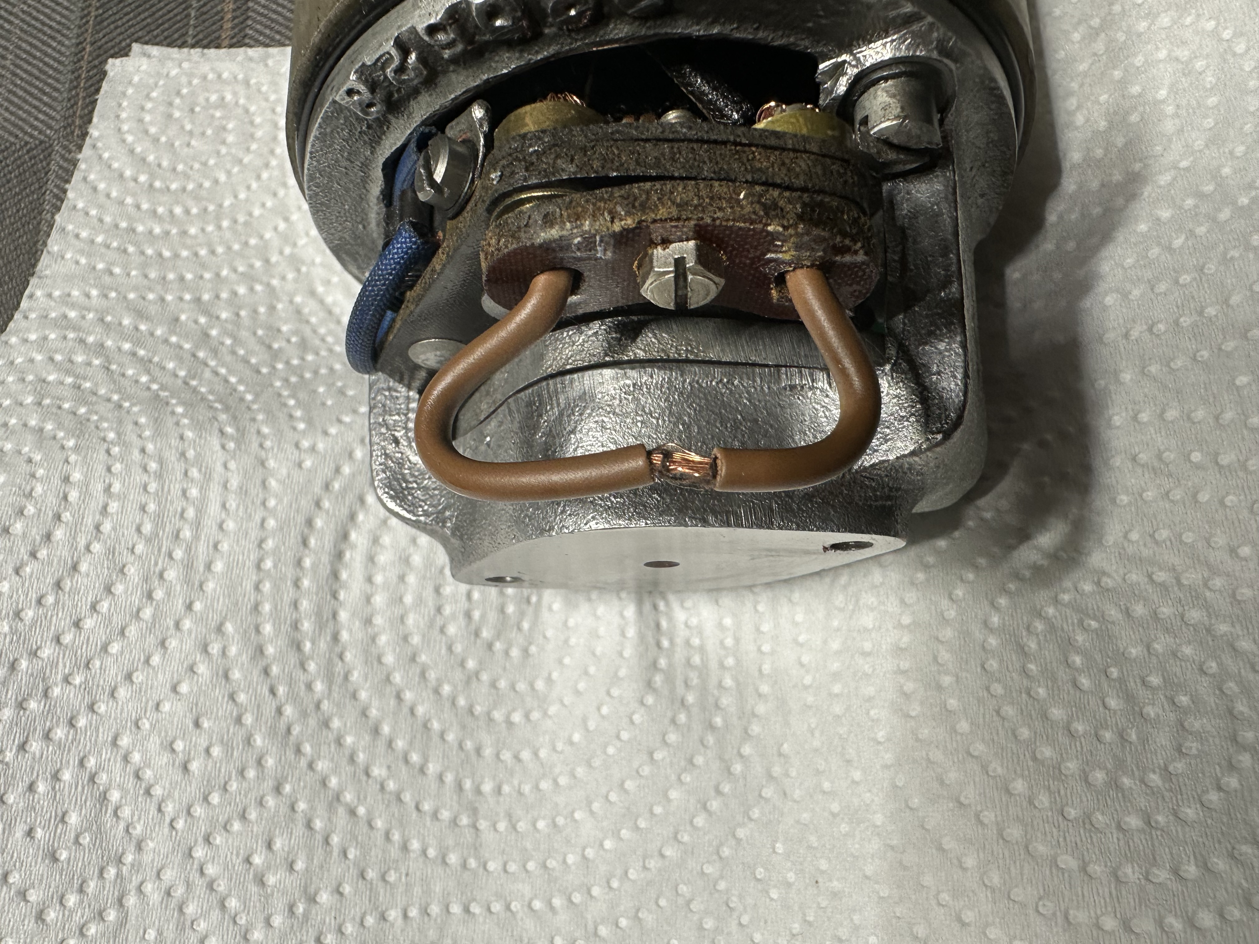

So after giving the unit a good clean, it was indeed caked in crap and oil due to a old faulty oil seal, I conducted your resistance check.
The upper measurement was 2,5 ohms but I could not get a resistance figure at all from the lower.
I have attached a pic of how I have connected the wires, one of which earths to the alloy body. Is that correct?
