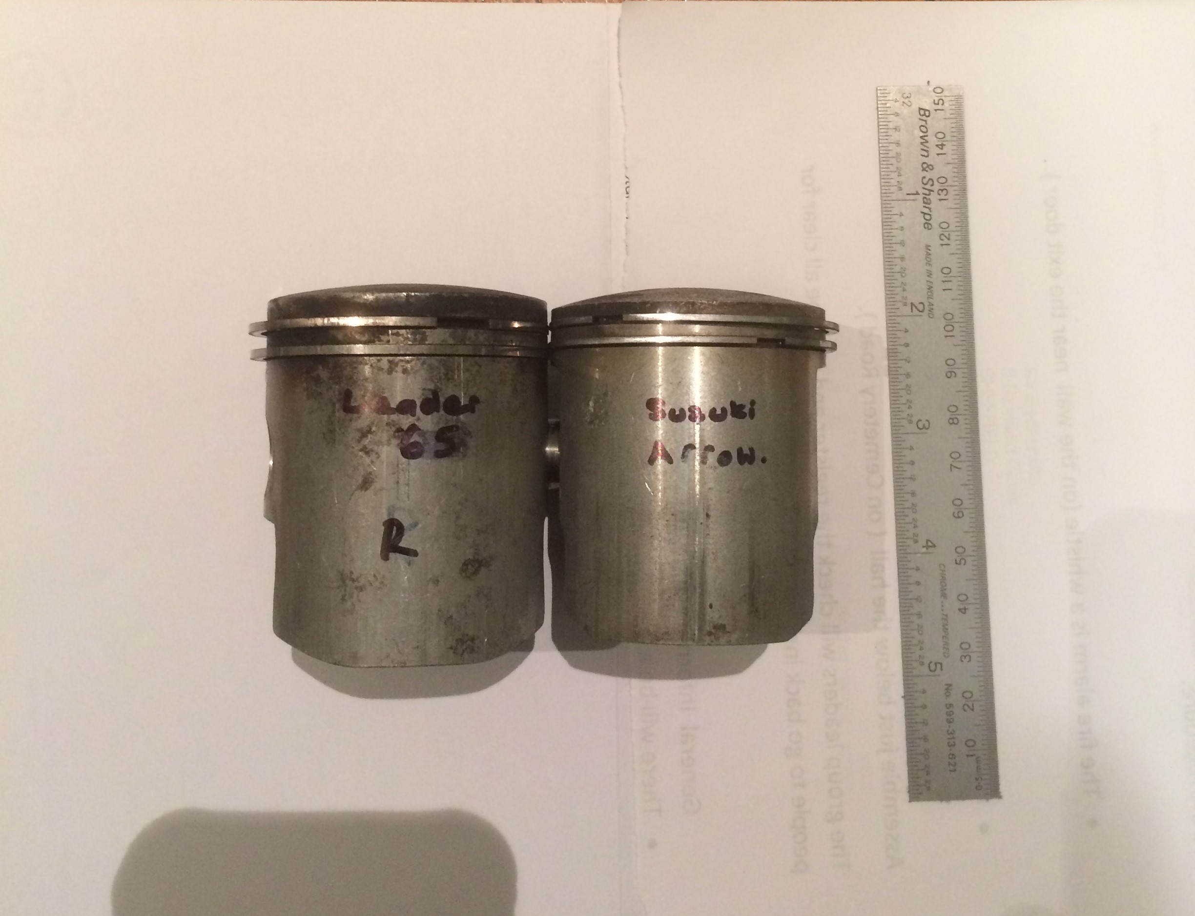

Attached picture of the Suzuki and Ariel pistons - gudgeon pin centres lined up. Its about 30 thou difference in the height. The skirt is shorter which in effect opens the inlet sooner so the engine revs more feely but has less torque in the lower rev band. I've taken the gasket out on one engine to increase the compression. Brain H.
