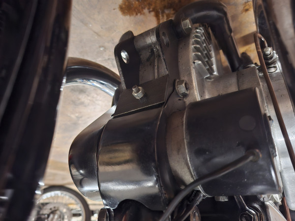

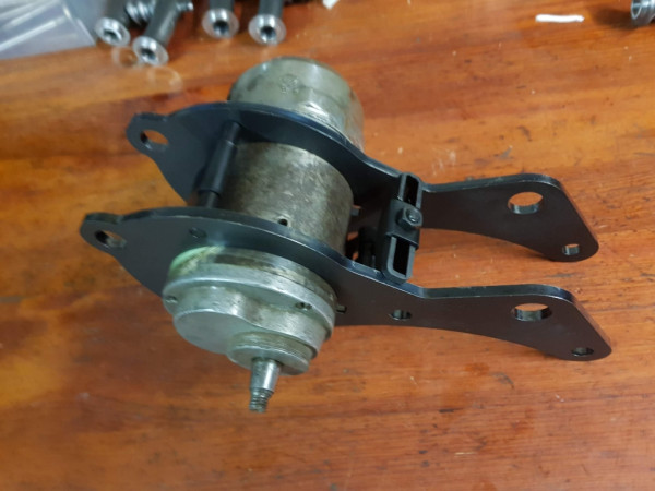

Could a kind person with a 1929-30 bike, the one with the forward mounted dynamo, please take a picture of the dynamo clamping arrangement?
I believe I understand how it works, but it would be great to see the E8/625 'clamp' and the E8/668 'bridge'.

Thanks Chris. Do you think that's the original bridge?

Re: 1929-30 Dynamo Clamp
I don't think so but it works. Came with the bike parts

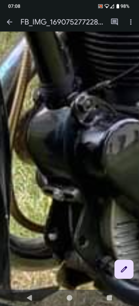

I found this on the internet when looking for similar information for the LF
It's far from the clearest picture ever but it does give some idea - I think.

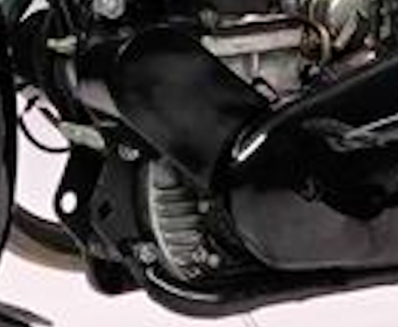

Thanks Will.
I found this too - it's obviously blown up a lot! It looks like a little casting?

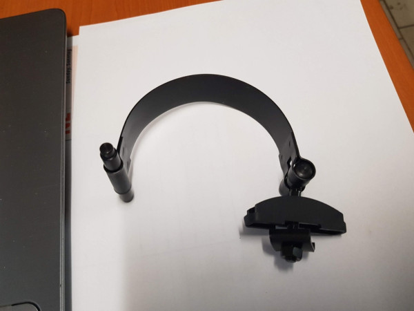

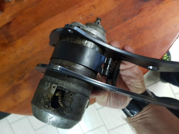

- Karol Burger
- Posts: 1198
we have produced it in the past, the stock has already run out
