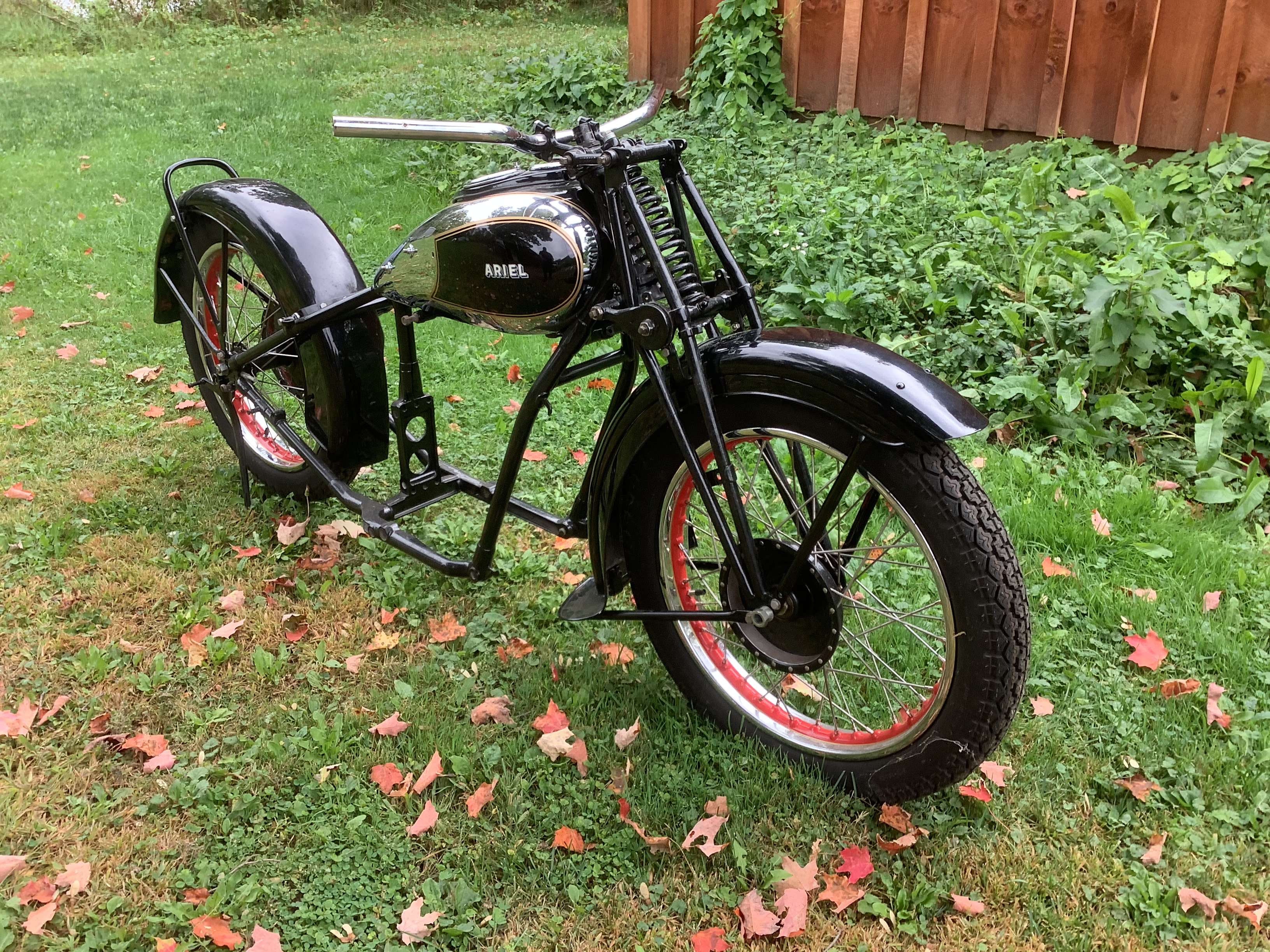

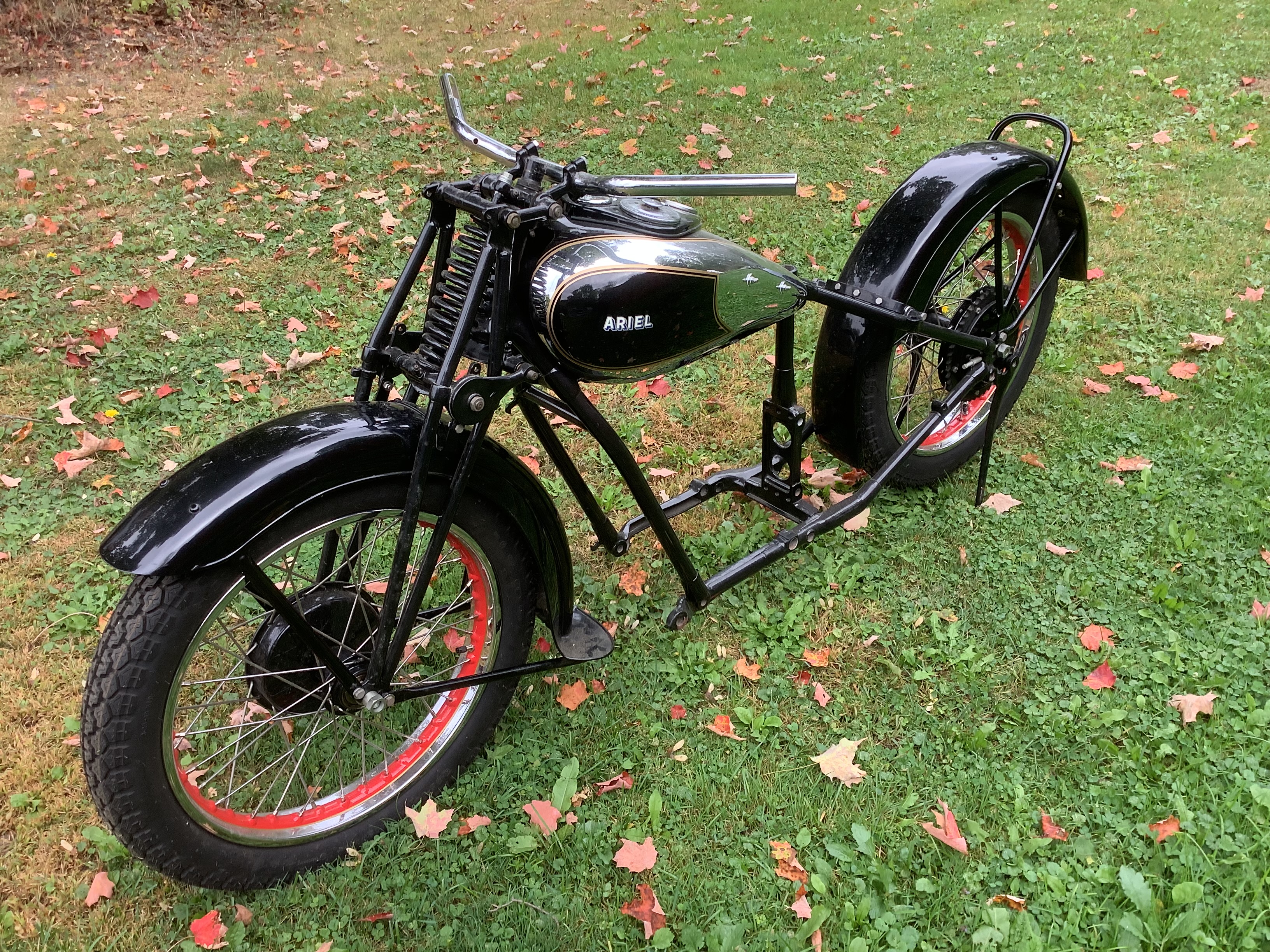

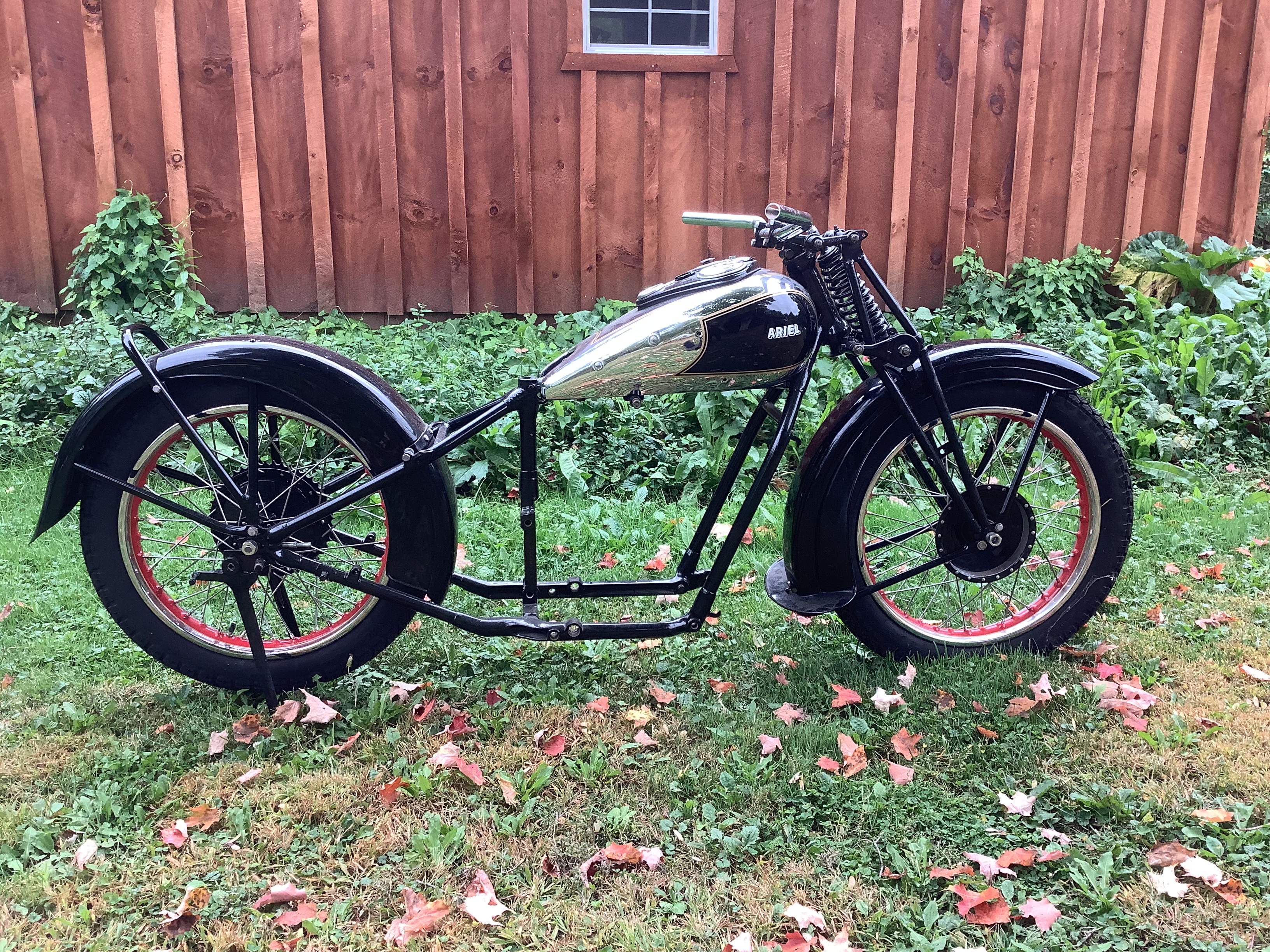

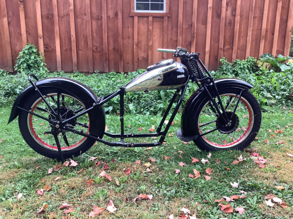

I will do better. Here are some photos of the best part of her...
The former owner started to restore her in 2004, but abandoned it. I'm sure that I will eventually find out why.
The first thing that I noticed when I looked at it was the drastic upsweep at the back of the front fender. It does not look like the photos I have seen so far of the 1932 SQ4. It is possible that these are from a 1934 VH, as he was building one of those concurrently in 2004. They may have been accidentally swapped. Thoughts?
Of course I talk to myself, sometimes I need an expert opinion :-)
Posts: 2003
Re: Liam's 1932 Cammy
Post by Simon.Gardiner »
Liam - that front mudguard doesn't look too different from what Karol has on his '32 4F.
Maybe take a look at the parts books in the online Members' Area library? https://www.arielownersmcc.com/members_ ... sBooks.htm
These show (illustrated) two front mudguard options, plain and valanced - yours looks like the valanced option.
(The 1934 singles seem to have used the same mudguard for the 'valanced' option).
