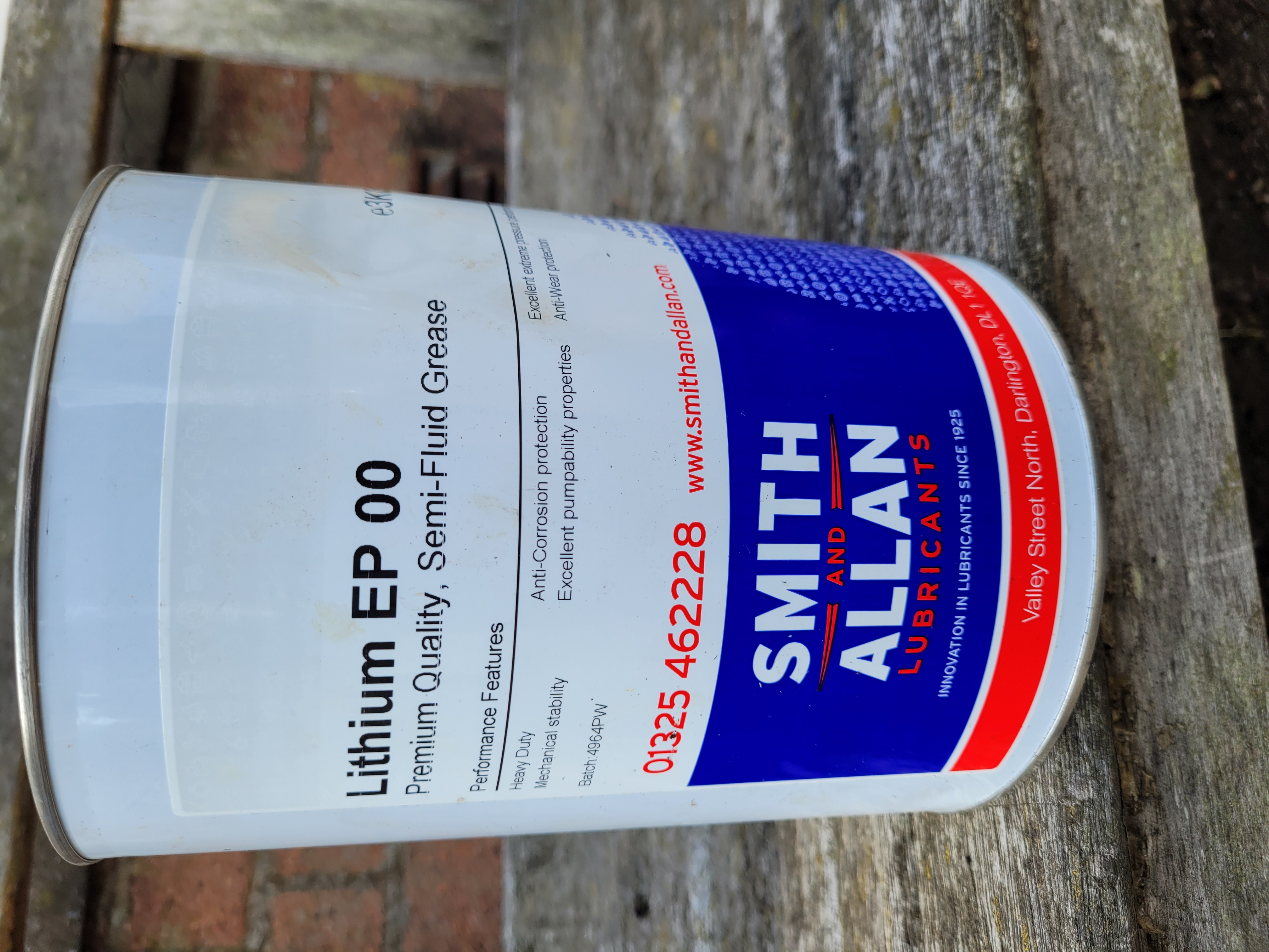

My 1931 Sturmey Archer LS gearbox uses a heavy oil.
I just bought 3 kilos of EP00 'slumping oil' from Smith and Allan:

Thanks for replies so far. Yes it uses semi fluid grease. I found one post that suggested that as long as the lower shaft was covered it would be fine as the great would work its way round. I would appreciate if someone who actually has the same gearbox could advise. All the Ariel literature just mentions refilling after a given mileage but not to what level
