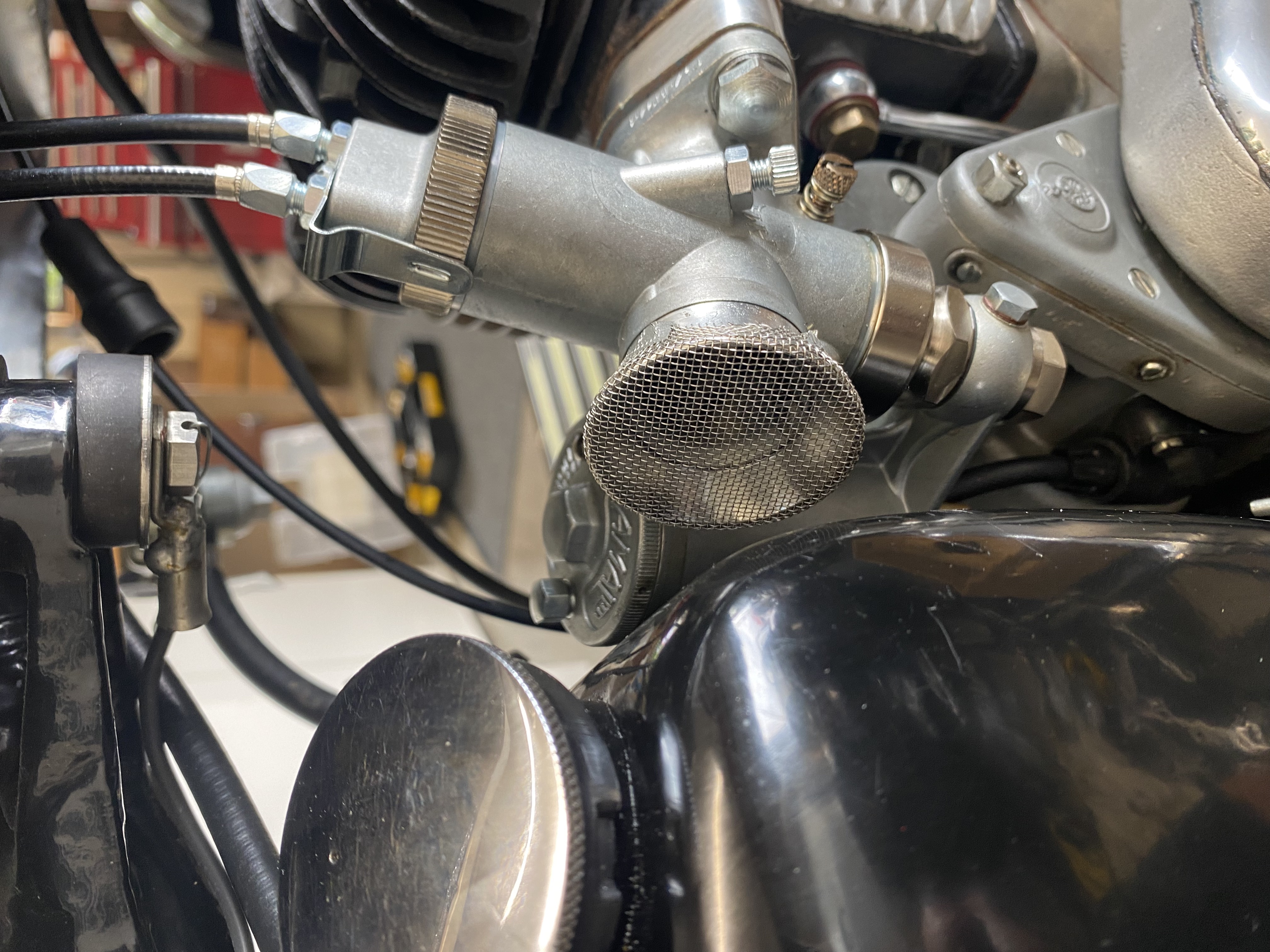

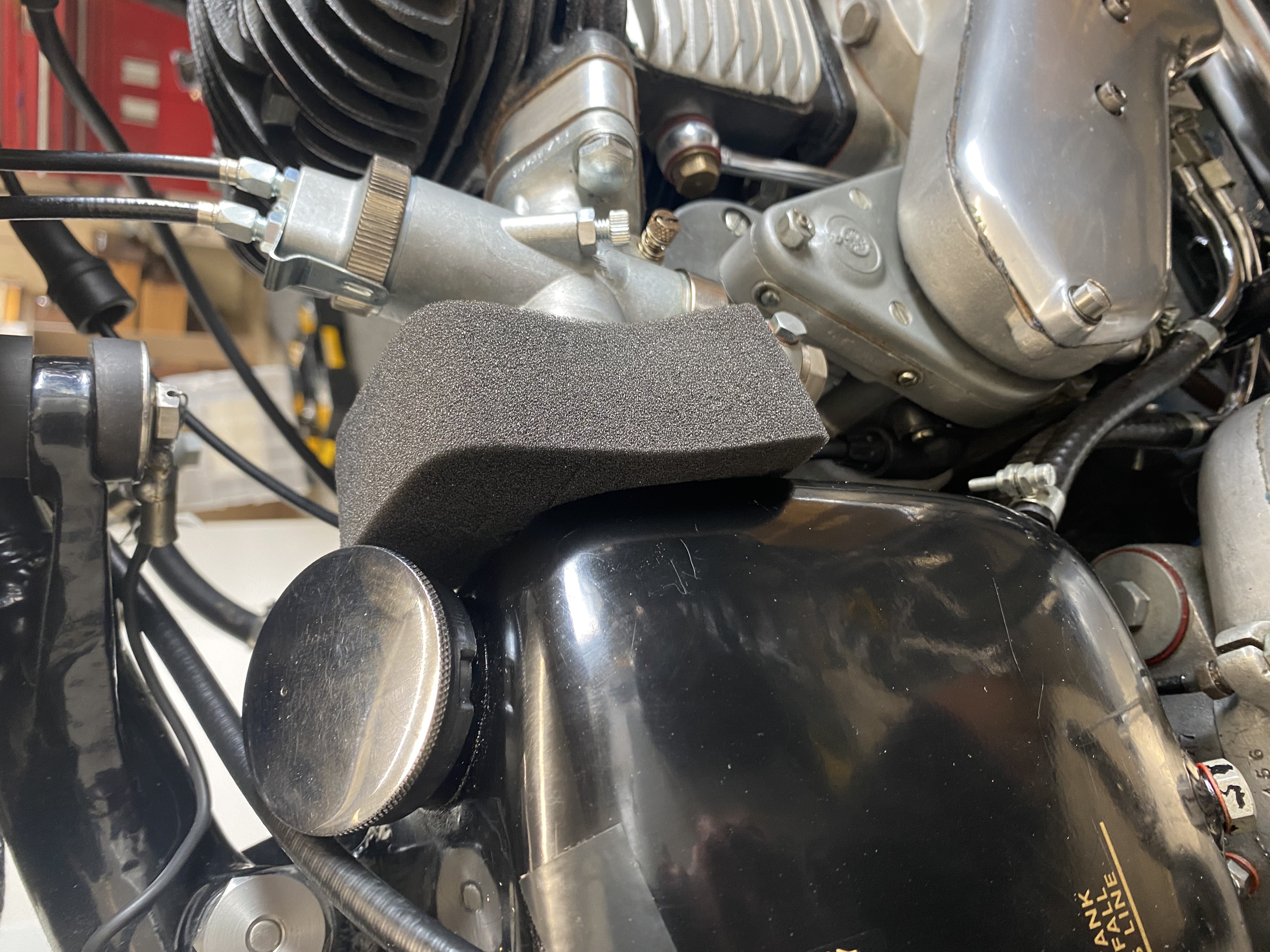

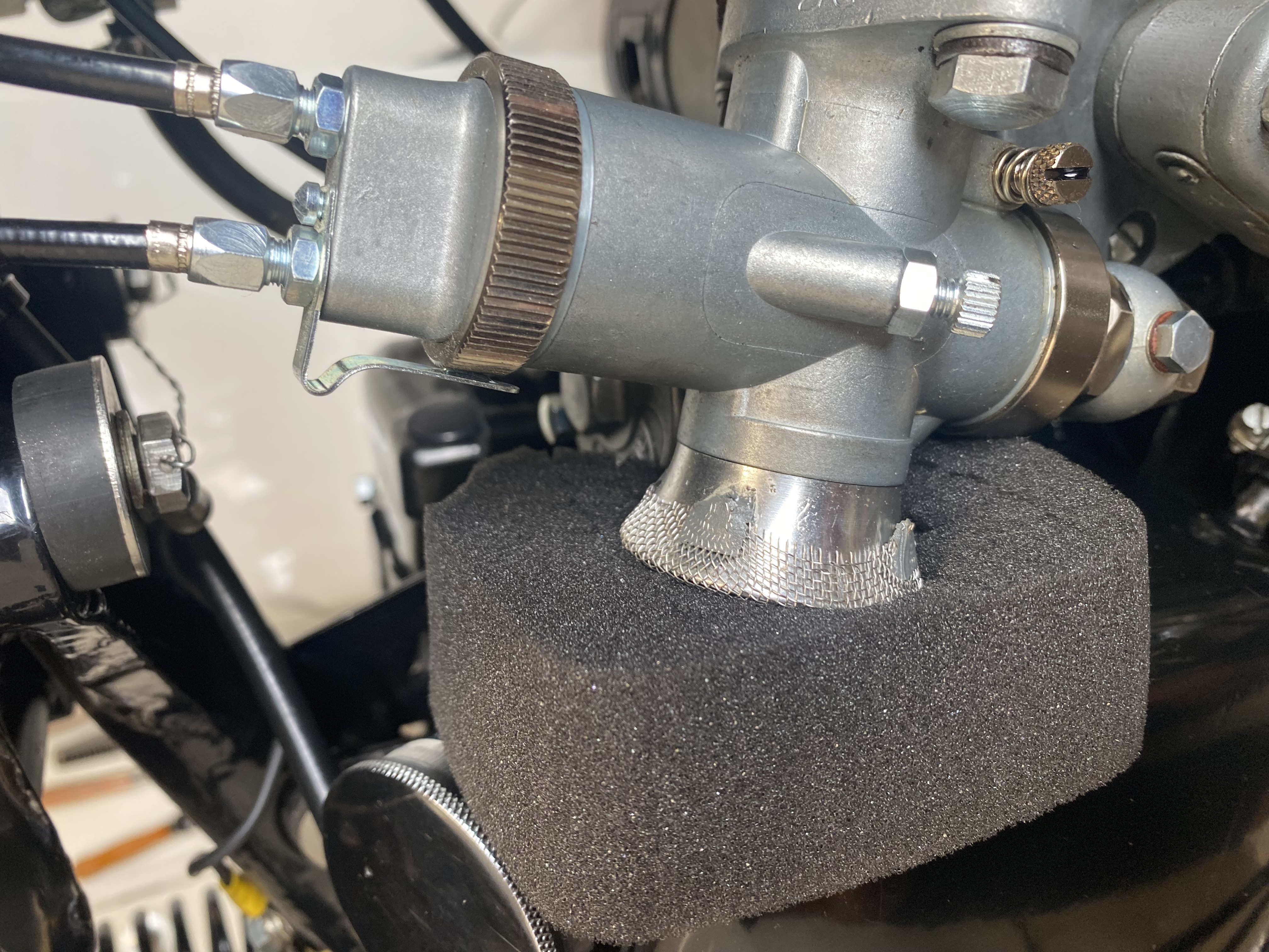

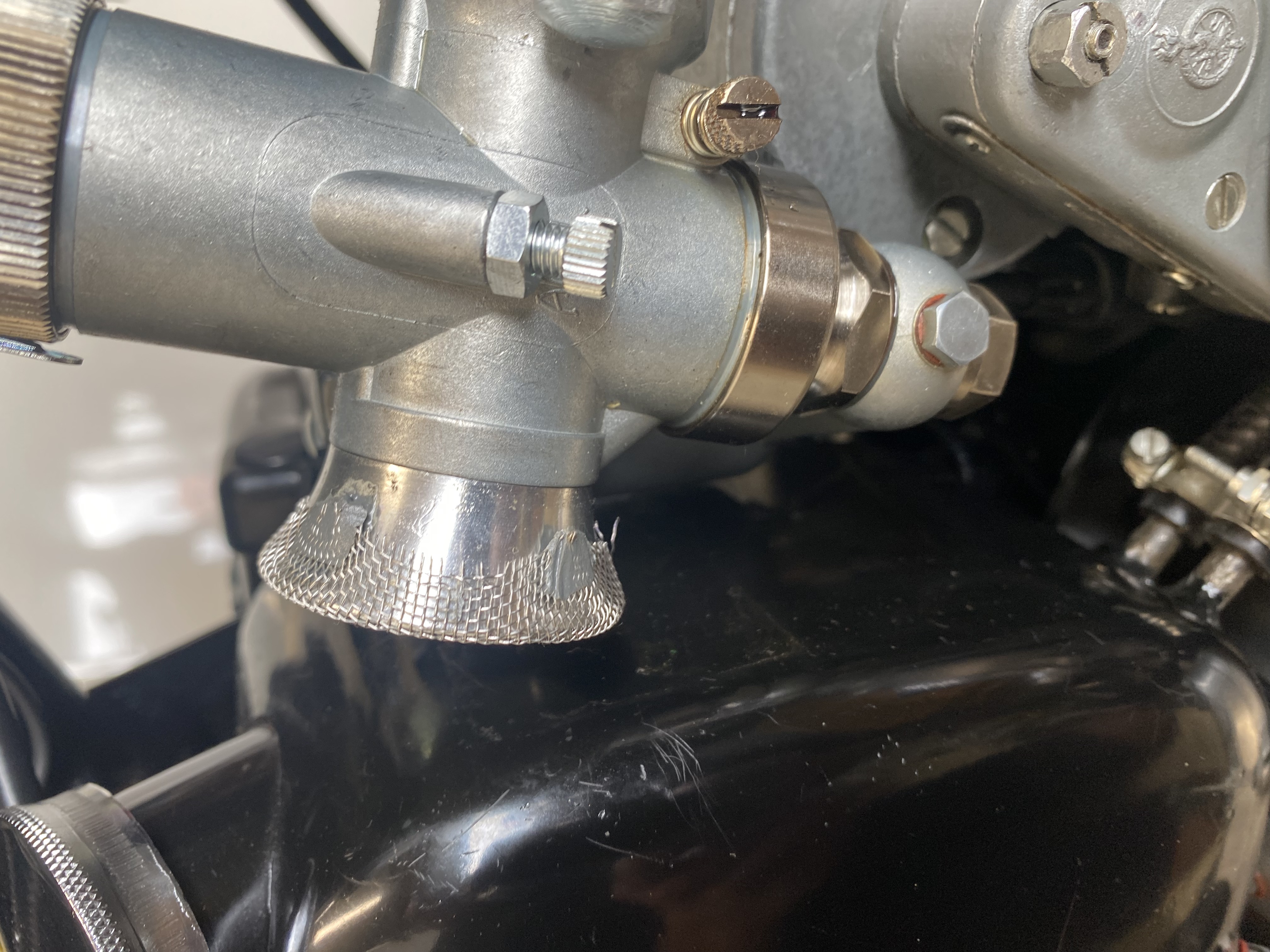

Hi Bevan,
Here is what I did ti fit an air cleaner to my VB, same s yours not much room between the oil tank and the short velocity stack on the carb inlet.
I visited the $2 shop and bought a small kitchen sieve with fine SS mesh.
Cut it out and formed it around the velocity stack and spot glued with JB Weld around the perimeter. ( The JB Weld that takes 24 hours to cure, not the quick set stuff )
Then found some fine black foam ( actually a pull out piece from a customised tool draw inlay.) and squashed it over the throat and pushed it in-between the oil tank. Works okay and it didn't blow off when I tried to start with the lever at full advance . Big Back fire ! no burns on the foam either.
Sorry if the pictures are not around the right way. Click on them and they are okay.
