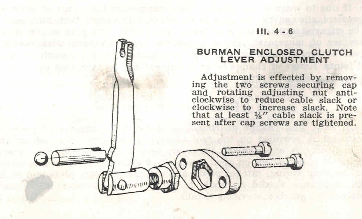

Can you adjust the cable enough by adjusting the operating lever? This is from Nicholson's book:

Yes, i shall probably have to do that. I just hope there’s enough adjustment there without the lever hitting the inspection cap…
