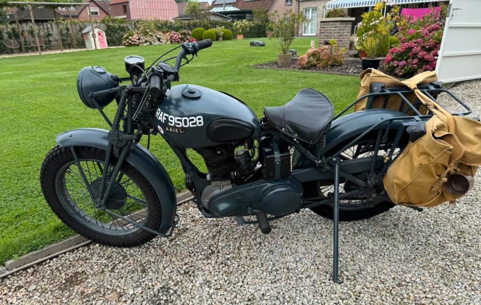

RAF blue WNG (No this is NOT Burney!)
https://www.2dehands.be/v/motoren/motor ... NjE3NzM4Mg..
No numbers shown or given.
Concentric fitted.
Hinged toolbox not there.
lower chainguard missing.
Postwar folded levers.
Wrong horn.(Wot!! no horn bracket!! :lol: )
Exhaust runs a bit wide to my personal liking and fixing point of that silencer begs to have it break away.
Tin prim.case on DS and alloy cover on TS.
Front mudguard too short (dont think its Ariel, perhaps Triumph?) and them stays are not the ones it should have.
Cant see what type chrono is fitted, but it does not look like a WD one.
in all.....
At 9K asking ! :shock: :roll: well....
In Belgium, between Antwerp and Maastricht (give or take a few kilometers ! )
I just notice that the field stick hinges from a spot not known as being the standard position.
can't really make out what has been cobbeld up...
