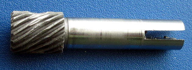

Im on the lookout for a speedometer driven gear for my BAP gear box. It's a 16 tooth variant - I understand that these may have changed over the years which would only add to the grief My box has the serial number XI BAPDH 55863 if that helps - so far I have not been able to find a website/information that would allow me to date it Thanks. Steve

Your gearbox number denotes a BA gearbox from pre war but with a sprocket oil seal, basic version.
The 16T speedo gear is 3150-47, used with Chronometric speedos 1947-49 when it was replaced by 3150-50 with 15T to correct an incorrect ratio 1950-52. Your gearbox would have used a PA speedo and a gear with 15T 3150-31 1931-46. Yes there are 2 gears with 15T but they are not interchangeable, the later one has a groove machined into the shaft to differentiate it. The matching layshafts are 11T 1934-46, 8T 1947-49 and 7T 1950-52.

I fitted the kit from gearbox spares.
Carefully reduced the shaft down, on the lathe, to get a tight intererence fit for the new end. Not sure you can do it, without a lathe.
I think my box was originally PA as well.

Thanks, John. Ive been in touch with Geoff about it and it could be a little engineering adventure with the Boxford is on the cards. Stripping the box wasn't my first choice - Ive done it a few times on my 37 Sunbeam which had a noisy BAP box (but no speedo drive) I cured that eventually and at a price, but it was the mess created by a grease filled box that was the real turn-off!

Geoff Brown of gearbox spares fame was extremely helpful and sent me a speedometer drive kit as promised. When it arrived I was able to compare it with what I have. My layshaft has an 11 tooth worm gear which measured up exactly the same as the new sleeve gear. I also found that the new 15 tooth speedo drive spindle meshed properly with the layshaft as it did with the new gear of course. All this got me wondering whether the 16 tooth spindle was yet another bodge job and it would account for the wear pattern on its surviving teeth.
With nothing to lose by trying it I loosely assembled the gearbox outer case and found that the speedo drive operated perfectly. That was all the encouragement I needed to put the old girl back together.
The new 35 inch speedo cable fitted without a problem and fed up through the tank to meet the chronometric speedo with any strain on the bends. Letting the bike run a slightly fast tick over in top on its stand, the speedo was showing a steady 25 which looks promising. Of course I didn't expect things to turn out so well this weekend so I didn't insure the bike on Friday - Im now pacing until Monday when I can get it on the road for a proper try out and find out how accurate or not the speedo is.
