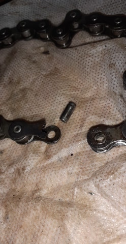

one side has sheered or broken off .
It's a renold chain/made in england

it is unusual for a good make chain to break but it can be a fault in the metal or made on a Friday i have seen it a few times over the years the roller just breaks up or the link go even with a good chain it can be lack of oil geting on the chain

Work on the assumption that it was the original chain, made in wartime conditions with an expected life of a few weeks for the bike. So failure at 70-odd years isn't too bad and at least it didn't wreck the engine, not to mention the major benefit of you not being under enemy fire when it went!
