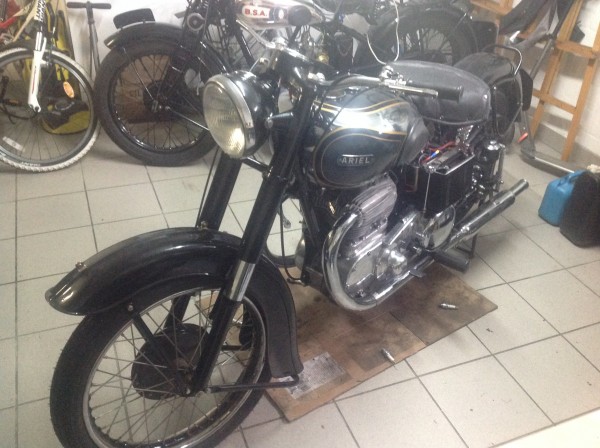

Hi there everyone,
I've finally finished rebuilding my Square Four from a basket case - only possible with a lot of help from all of you here in the forum. Many thanks for that!
This weekend I did the first start attempt, and she starts briefly for a few seconds and goes out. It almost seems she floods because afterwards she gives me no signs of wanting to start again. Taking the plugs out they are a bit wet, I then turn the engine a few times to clear it, do another attempt, she fires briefly and goes out. The engine is still very tight, and after a while I give up, as there's no strength left to kick it further.
My settings for starting are:
Bi starter pulled all the way out
Throttle fully shut
Ign on
And kick away
Any advice on what to check or adjust for the first start? I have a solex carburetter. How many turns out does one set the air screw? Is there anything else one can adjust on the carb?

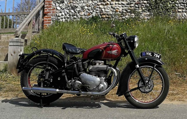

By the way, do you have a small front wheel? The mudguard looks very high at the front.
Here's a picture I took yesterday:
I've still got the KH tank fitted.

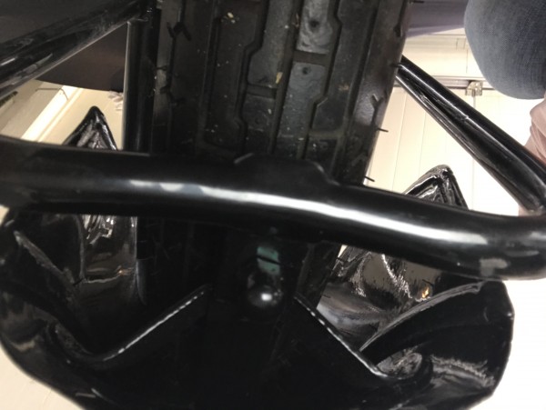

What about if I measure my stays and compare them with yours? We can also look at how your front stand is fitted to the guard.
Re: Square Four MkI restoration complete - almost....
Got it
There was a fibre washer already under there, but I added a second one just to try it out.
The front stays measure about 29mm from the fastner‘s centres. Here‘s a pic of the front stand‘s attachment. However the angle of the mudguard is set by the center stay beween the fork legs isn‘t it?
