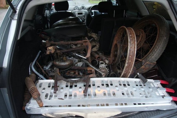

State of progress of my KH Project, fromas bought (from the wonderfulPaul Jamieson via e bay), and present condition of the chassis
[img][/img] Best Regards
Dave Smith

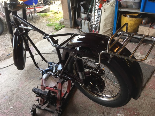

Dave Smith

It is looking good Dave!

Looking good Dave. What are you painting the mudguards and frame with?
Another question if you don't mind. How do you find that lift? I don't have the space for a full size table lift, as like you I work in a conventional garage, albeit with a mezzanine storage area overhead.

Looking very good indeed - keep up the good work!

Looks like one of these https://www.ebay.co.uk/itm/143022260550simon.holyfield wrote:Another question if you don't mind. How do you find that lift? I don't have the space for a full size table lift, as like you I work in a conventional garage, albeit with a mezzanine storage area overhead.
Looks just what I need too.

I shall be in town with the truck tomorrow. Wondering if I should use the opportunity to buy one, or whether I will be forever worrying about the stability of the bike on top of it?

I have my 'VH' on one at the moment, they are very stable (still best to strap the bike to it).

That looks too precarious for me - I use a Sealey 365 'X' lift:
https://www.sealey.co.uk/product/563719 ... -hydraulic
I remove the ramp when in use which reduces the footprint and when it's not in use it's folded and up-ended to store against the garage wall. Wouldn't be without it.
Regards Mick

I have something extremely like the Sealey X lift but without the Sealey name on it, which probably reduces the price somewhat. In its original form it is ok for a centre stand bike but considerably too short for a rear stand bike. So mine has been modified somewhat so that I can just get a rear stand bike onto it by means of an extension to the front. This is not something I would advise others to follow blindly as the action of the X system when raising the table leads to a danger of overturning forwards if you were sufficiently incautious. So as a relatively light and easily moved ramp for centre stand bikes it is fine - but not at all easy to use for a rear stand bike.

The lift is a generic chinese one off of e bay,I find it fine, but have welded a bracket to it that at present bolts through one of the holes in the frame. The standard rubber covers are a bit prone for the bike to slide around and could be dangerous.When I had my BSA B31 special on it I strapped it on which is very necessary. A welded on bracket is better.
Dave
