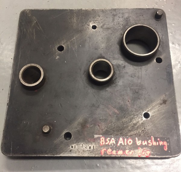

The issue you will face by doing this by hand isn't alignment of the holes when you're done, it's that without rigid and accurate support of the reamer when doing the first bush the hole will end up barrel shaped. BSA had a special tool for aligning the reamer for the timing side main shaft bush on A10s that consists of a thick piece of steel with a further steel bush in it, along with holes to bolt it to the timing case. This "outrigger" bush aligned the reamer so it entered the bush accurately aligned with the mainshaft (at least, as best as possible without having the cases on a mill) and kept the reamer from any off-axis movement to eliminate the barreling that will be inevitable if you do this without such a jig.

Not too far off topic is this photo of the A10 bush reaming jig I mentioned in an earlier post. They seem to be fairly uncommon. I don't even remember where I got mine but it must have been in a batch of parts. I photographed it at an angle so the three-dimensional character of the alignment bushings would be more apparent. It's made of 5/8" steel so is quite heavy.
