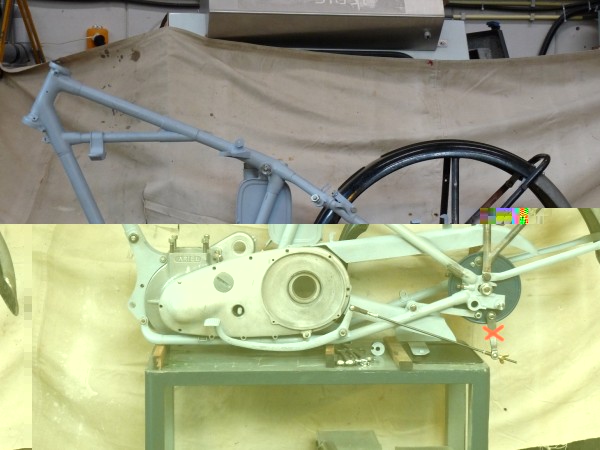

Hi Fellows
My WNG no have the original anchor bar in both brake plate.
Can send me a drawing or measure to reproduce these 2 pieces correctly?
Thanks in advance!

Hello Luis,
see the picture, this is how it should look, (more or less) but the brake lever in this picture is to long.
It should be half this lenght.
The brake rod runs inside the rear stand, yes, very litlle space but it does....
The anchor bar has a small kink in it to clear the frametube.

Luis,
It's difficult to see if this is a Ariel brake plate, it could be something else.
Now the wheelspindle can not be taken much more backwards to tension the chain as the anchor is in the way.
If you turn the brakeplate clockwise towards the position it should be, the brakearm will be below the wheelspindle where it should be.
I think the brakearm itself is from a later model frontbrake, but if it works o.k. then use it.
I see that the rear stand has it's spring on this side, Ariels have it on the other side, the spring abutment on the frame is a later addition.

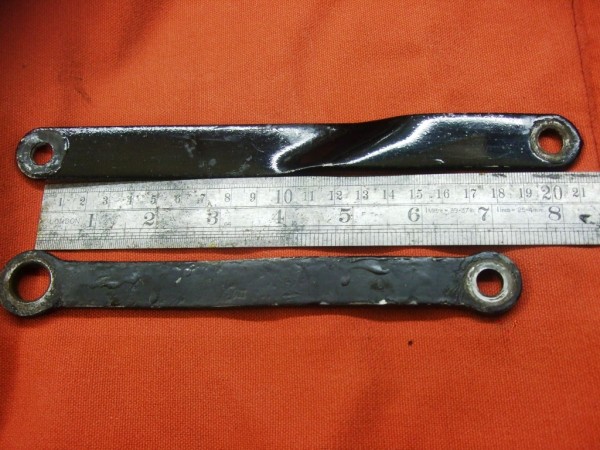

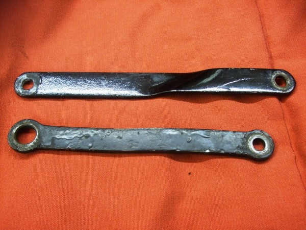

I happen to have my 36VH rear brakes apart for refinishing, heres a couple of photos
Front brake arm on the top

Thanks for the photos and comments!
