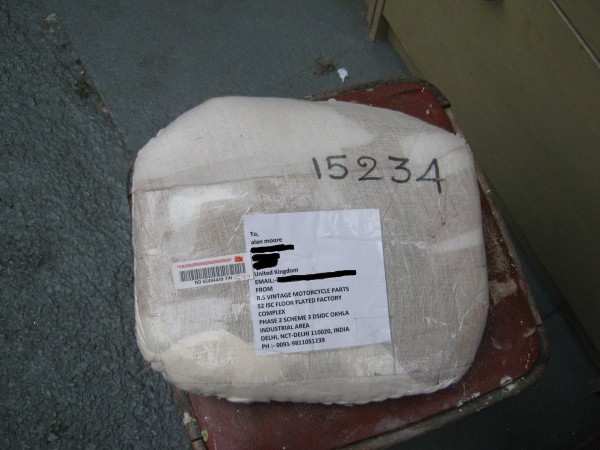

My 1939 Rh came with a late 1940's rear number plate. The restoration is on a budget and is not going to be brochure perfect. Found a period rear number plate on Ebay...£25 including postage from India :). Ordered it 7th Sept, arrived in UK on the 12th and delivered by Royal Mail on 15th. That's what I call great service. Came well packaged in a hand stitched cotton 'bag'. No extra's to pay (i.e VAT or post office surcharge).
What's it like? Well it is well stamped and the metal is a good thickness. It will need a bit of alteration to make it more like a 5647-39 but it is a good deal compared to the £70 for one from Drags. Just need to get a car version of the Lucas 1130 lamp (an original Ariel one went for £333 on Ebay in 2013!!)

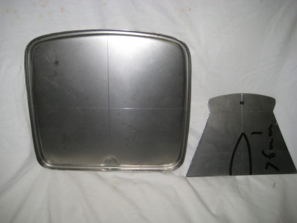

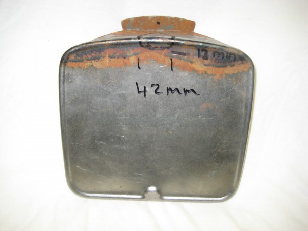

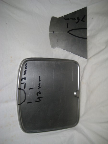

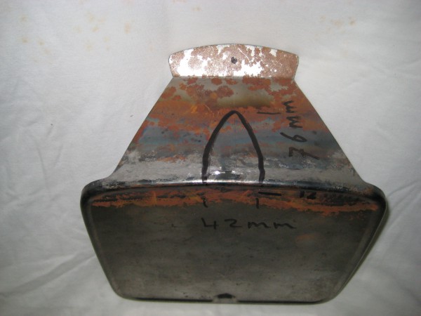

Post by adrie.degraaff »
I have made the 10 plates, they come with torpedo-light measuments.
The main has a centerline at rear, the wing at the top becouse the light will be cut out.
1 mm thick.
