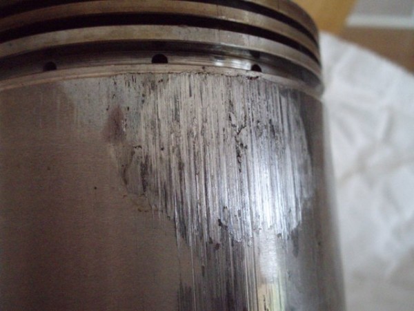

Attached are some photos of the piston. I will get measuring the barrel and piston clearance as advised.

That is a good seizure.( I don't mean it is good for the engine however) When This happens the piston may/will increase it's clearance because the very hot part shrinks. Some pistons will acquire a hollow where the heavy seizing has taken place.
As pistons that are made of aluminium expand more than cast iron barrels, you will experience more piston noise when the engine is cold, than when it gets hotter. IF the noise doesn't diminish when the engine is hot, you might have another cause.
A seizing piston does put an extra load on the rest of the motor. This can cause the flywheels to go out of true and put a large load on the big-end. If it was on the way out the extra load could finish it off. Sometimes some ot the aluminium from the piston skirt will weld on to the cylinder surface and has to be removed. Check that this hasn't happened.
I've had pistons seize like this and re=used them. You have to check what actual clearance the piston has. They are oval as well as tapered and depending on the material used in the alloy will require an appropriate clearance. It is most likely that the clearance was not enough in this case. If you are working a bike, it is better to err by more clearance than the minimum, than not qute enough.
The design of the piston can have a bearing on the clearance as well. The T slot piston can have less clearance. because it has "give" in it's design. The solid skirt type, ( preferred for hard work) has nowhere to go when it gets hot, so a bit of piston "rattle", when the engine is cold, may be prudent.
Regarding the rebore to .060" this is only .010 bigger than at present and your rebore man may find that the previous rebore wasn't quite true so more might have to come out, than .010". The barrel of the 500's will bore to .060, but you are always better offf with as much of the original barrel there, as possible.oversize pistons are always heavier than they should be because they become thicker than the originals. JP pistons are usually a bit heavier to start with, compared with the OEM pistons. Nev

Hi Carl, I think the back of the piston is the main thrust face, so this makes sense. I have a piston that looked just like yours, which is still in the bike. I did try the things you and others have talked about, including stressing over oil feed and jetting, running a 220 main, etc, etc. Just as Nev says, it rattles a bit when cold and gets better as it warms up. After the seize, I ran a hone to clean up the marks and filed down the rough edges around the damaged area of piston.
JP's are very well known for this. As Nev says, they are also heavy and they can affect engine balance.

Done some measuring and the barrel is fine with a 10 thou piston ring gap all the way down. The piston body to barrel clearance (on the non-scored bit) is between 8 & 9 thou at top of the skirt and just uder 5 at the bottom of the skirt. These are on the thrust edges. Do these seem OK? Cannot find this info in my ariel w/shop manual.
So, it looks like I can carefully clean things up, turn the piston round and expect a rattle on initial statup and quitening as it gets warmed up. Brenton, Draganfly M/Cs here in UK have several variants of Ariel pistons but I am not sure if they are JP.
