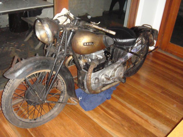

Can tell you after new year. I have very original 1936 cammy but in storage and I am travelling from tomorrow. Guard is ribbed and I am pretty sure hinged but will confirm.

hi thanks Richard your bike looks very good , can you also look to see if the tail section is plain at the bottom or pattern like the later square fours

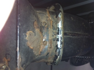

1936 Cammy rear guard.JPG (30.94 KiB) Viewed 4394 times
Dear Rodney, sorry this is so late. Pic of rear mudguard and hinge section of my 1936 600cc cammy. Hope this helps. Richard

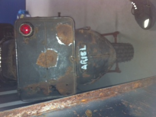

If you look at the original photo I sent, you can see the shape of the tail of the rear guard. It is not flat. I will take a better photo when I visit my storage site next.
Richard
36 Cammy rear end.JPG (28.45 KiB) Viewed 4224 times
Here you go. A pointy tail. Hope this helps. Let me know if you want me to trace the shape.
