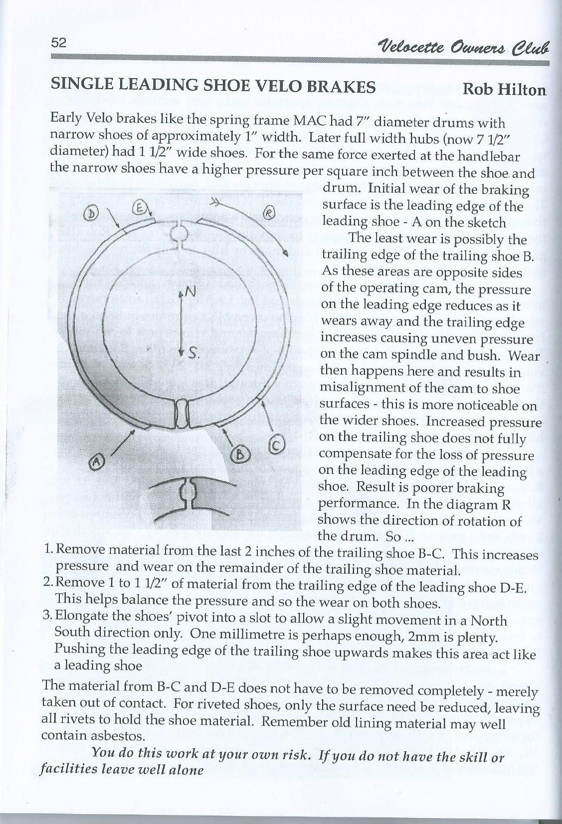

- Posts: 1197
Re: Single width brakes shoes and cams
Is this the article?
- Posts: 2011
The V was for Vincent not Velocette. The Vincent one went on for numerous pages with graphs showing variations in coefficient of friction against temperature for various materials. It was like a PhD thesis. I think Rob is wrong in removing the material from the leading edge of the trailing shoe as this part does contribute to the braking, whereas the trailing end contributes very little except to prevent the rest of the shoe touching the drum. I stand to be corrected by someone whose brain is working better than mine. Cue long discussion....
- Posts: 5646
Removing it from the leading edge of the Trailing shoe Increases the Leverage and braking effect of the rest of that shoe and also allows more wear to keep pressure on the Leading shoe. One consideration is, is the "Trailing" shoe itself strong enough to not bend or break? You can very successfully tweak these brakes if you Know what to do. Nev
