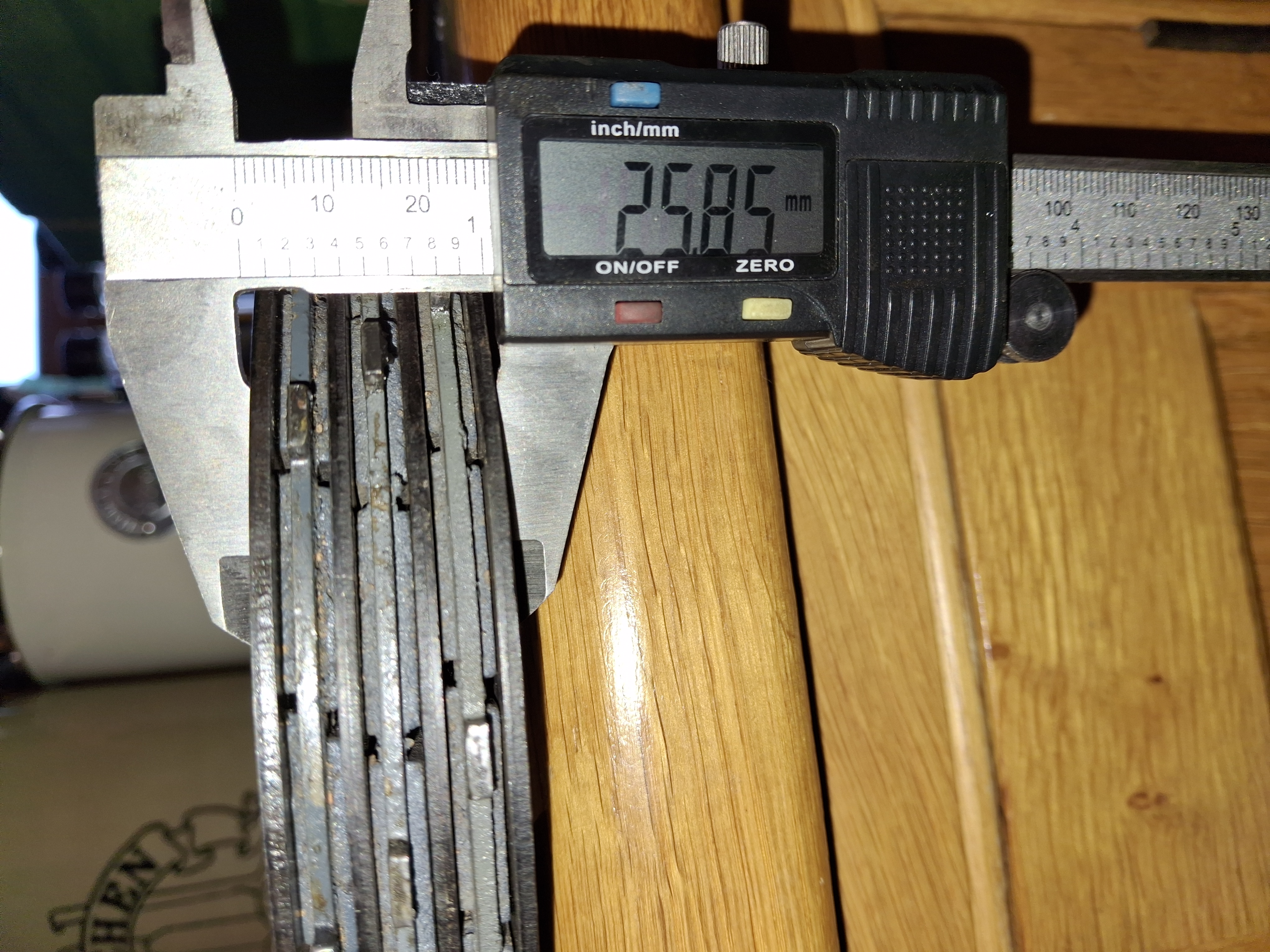

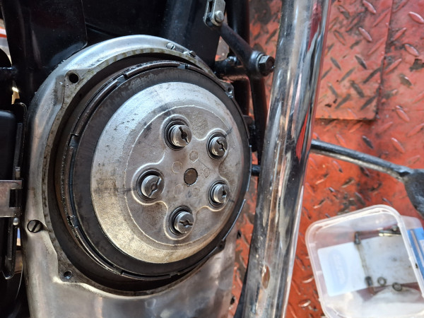

Re: Vh500 clutch
So I cannot see anything obviously wrong. The plates are not warped, the four steel plates are all around 2.0mm in thickness, and appear to still have manufacturing pattern marks from new. The corks all look in reasonable condition - but I am wondering if they are getting a little thin. Can you judge from the photos? They measure around 5.5mm thick. The whole stack measures about 25mm.
The springs all appear OK, and are not hugely strong, I could undo the screws by hand, but made a slotted tool to make it easier. I am not aware of any clutch slip when riding, so fairly happy the springs are strong enough.
The basket does not look worn and there are no wear grooves - there is end play of around 3mm; meaning the basket can pull out and in by around 3mm, I assume this is normal?
I won't dismantle any further for now - I'll get some feedback first. Thanks in advance.

- Posts: 5152
Re: Vh500 clutch
Do you mean the basket moves in and out by 3 mm with the clutch centre in place? Sounds like the thrust washers are missing, unless you have a lot of mainshaft end float.
How much does the clutch centre move in and out?
