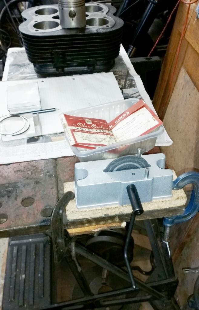

im using +.060 filed down rings in my +.040" bored ajs 600 twin .
the story behind it is that i had a little knocking noise when i bought it 15 years ago and found the "new" gpm pistons in it had nipped up and then i found it was only bored with .001" running clearance , so i got some new GPM gandini pistons and rings and i honed it out for .006" running clearance , this then caused the ring gap of the +040 rings to be around .025" and the maximum [ worn out ] ring gap limit for the ajs is +030" .
so i bought some +.060" rings and filed them to fit the +.040" bore and give me .012" ring gap and i put the +.060" rings on the +.040" pistons , it has been running that combo since then and i even changed the rings again one year after i did the job so that i could see if all was ok still , and it was .
i dont normally give the engine a lot of stick but i have ran it almost flat out on occasions and it still runs lovely .
what i would say though is to use one of those rotary ring filers you can buy cheaply these days and dont grip them in a vice and run risk of breaking them , ive been there and got the tee shirt ! .

What is a 'rotary ring filer' ?
Got a link to a supplier ?

https://www.ebay.co.uk/itm/317286930624What is a 'rotary ring filer' ? Got a link to a supplier ?
