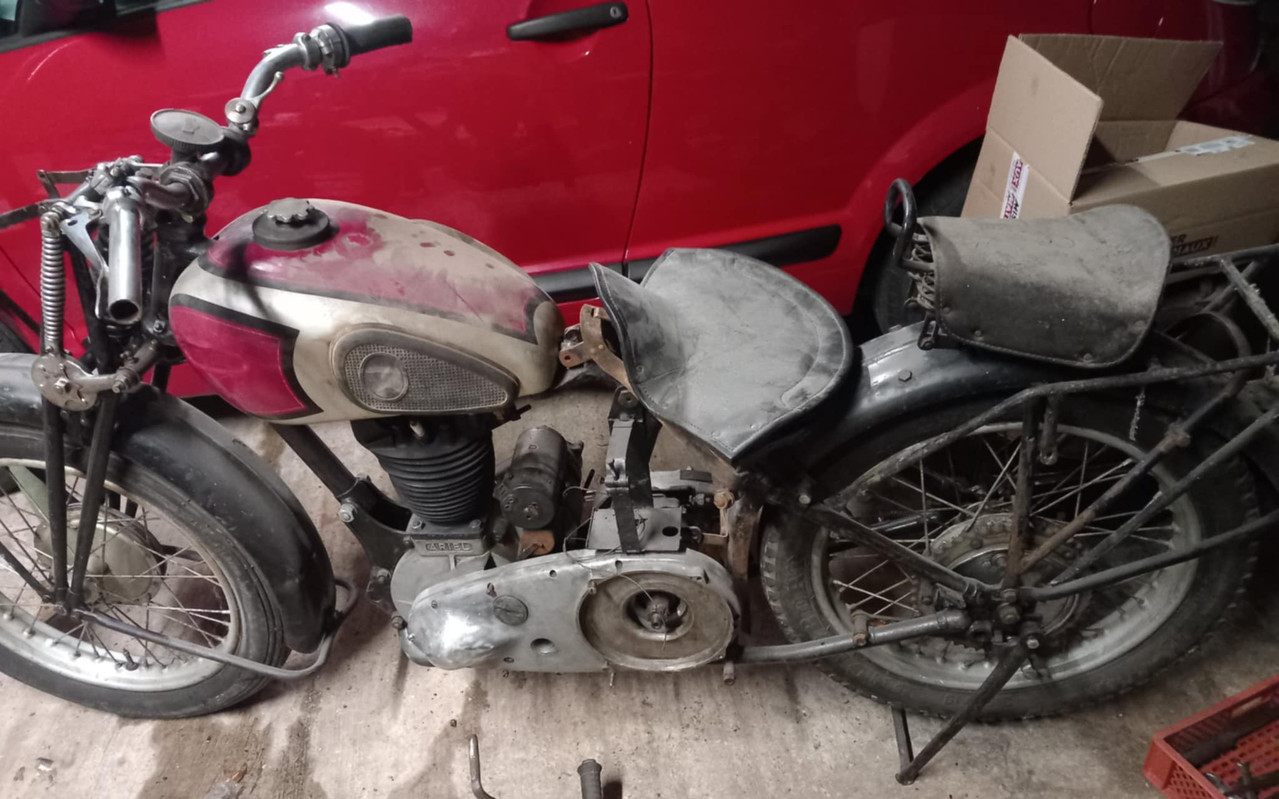

Hello everyone,
Thank you for accepting me into the group.
As a new owner of a W/ng,
I've just discovered the secrets of the "Siren" through your various posts.
Mine has a frame number XG 23610, which, according to initial research, dates from February 1942.
Its engine is an RAF RBH 25..., which may not be its original one.
In the purchase agreement, there's another engine, a BH 15..., which might be its original one. Further research will be needed.
Prestone

Welcome to the fascinating world of Ariels and W/NG in particular.
XG 23610 comes from a batch of number that are not listed in the despatch book. It is assumed that these numbers, there are many, belong to frames supplied as spares with each contract. This batch of unlisted numbers is from 23,512 to 23,750 and is between contact C 10,477 that was completed in March 1942 and contract C11,103 begun February 1942. The engine numbers may help to work out which contact this bike came from as most W/NG do not have the original engine but most have one from the same contract. Any other numbers would be good as well such as the gearbox.

Thanks Roger, for these very interesting details.
Here are the numbers for the frame, gearbox, and engine currently fitted to the Ariel.
I'm waiting for your opinion on the "milkshake" of the "siren."
Posts: 2096
Re: New project " Belgium Siren"
That does the job. Engine is from contract C/S 14218 which was for the RAF in 1943, The frame I read as XG 23810 rather than 23610, which does exist as a 1942 Army W/NG from contract C 11103. The gearbox is the correct type and is probably from 1942 though they are difficult to date. So the siren has been shaken, whatever that means, possibly lost a little in the translation!

For Roger,
This information is interesting.
What number range should the engine number fall into?
I received two other engines with the motorcycle
When I say "milkshake," I mean a mix of parts.
Posts: 2096
Milkshake I understand now.
This motorcycle was supplied as part of a contract for 3,500 W/NG dated 27th February 1942; delivery to Chilwell Ordnance Depot commenced on 10th February 1942 and was completed on 11th August 1942. The specification was as contract C 10,477 and they were to include pillion seat, footrests, and pannier bags. Also supplied were 210 engines, 158 frames and 140 gearboxes. They were to be delivered at 650 per calendar month after contract C 10,477 was completed. They were allocated census (tank) numbers between C 4,692,899 and C 4,696,398. The engine numbers were BH 15,001 to 18,500, the frame numbers were XG 23,751 to 27,250 and they cost was £62/-/- each. Census (tank) numbers were usually applied at the factory prior to despatch in approximately date order, however the motor cycles were not built in numerical order

For Roger,
we can't give a more precise answer.
The company registration number (SIREN) does indeed match the contract via its equipment.
Among the engines supplied, there is the BH 15067. Is it possible that this is the original?
Preston
Posts: 2096
Nearly! The original engine for XG 23610 is BH 15073. Very few W/NG have their original engines because if there was a problem with the engine, instead of repairing the engine a spare one would be fitted and most of them had a hard life. If you have an engine from the same contract this is very good. I assume that your frame number is 23610 not 23810?
