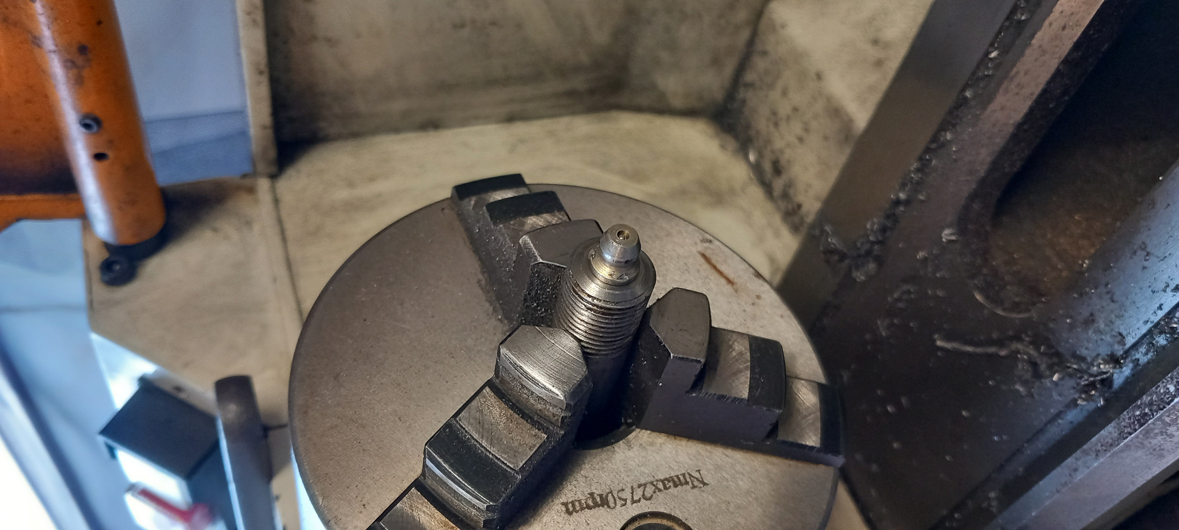

As mentioned earlier, beware the 'mullered' axle grease nipple, mine as inherited & after a bit of fettling in the lathe ...
After fitting the new nipple, pump a lot of fresh grease through to ensure the passage is fully clear, then one pump on assemby & once every 1000 miles thereafter.
