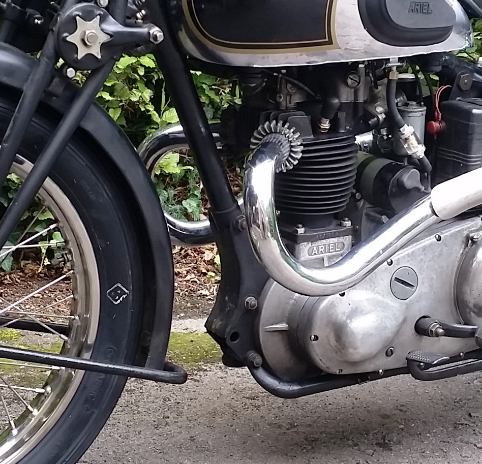

Roughly what year is it? To clamp effectively they'd have to be CNC'd from steel. Some clamps have no fins. Nev
Re: Broken exhaust clamps
The "clamps" are often made of malleable cast iron or aluminum and act more like cooling rings - they don't have enough strength to bend the headpipe and hold it there. I've broken both types. And run with a broken one for years. My recollection is the twin port head has 1 3/4" OD pipes that are the same as Triumph twins and that some of the Triumph clamps are steel. There should be no difference in the OD of the high and low pipes so your broken "cooling rings" should also fit on the high level pipes too.
- Posts: 5634
The "Black Ariels" and the W/NG never ran finned clamps. Mostly a styling thing. Nev

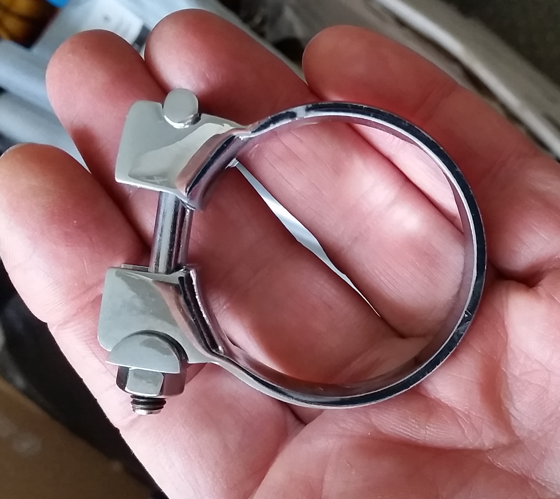

Pete.Silson
- Posts: 385
This is the original non-finned clamp that was on my 1946 SQ4.
Some very good replicas of these are available:

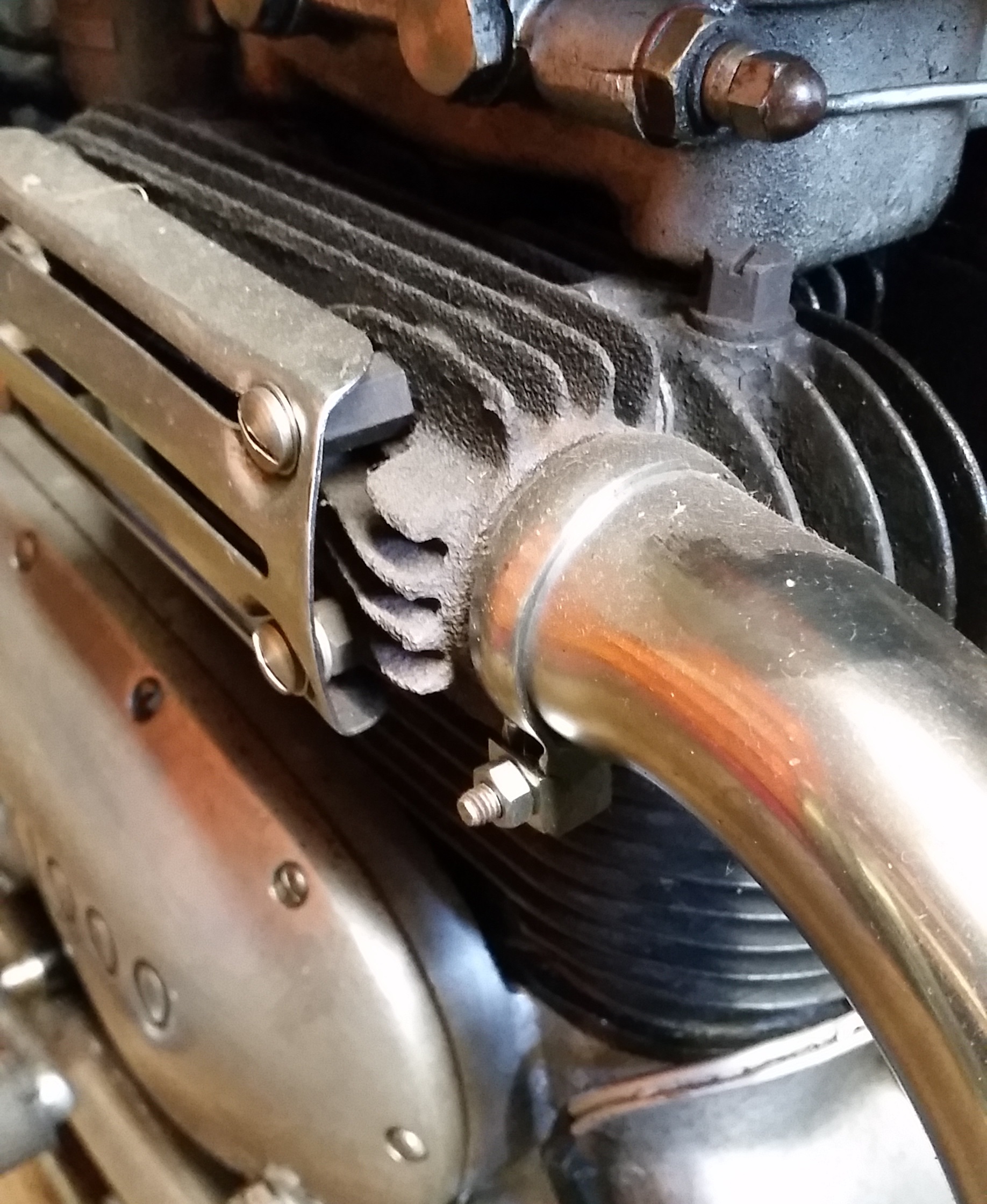

Pete.Silson
- Posts: 385
The plain ones pictured above are chrome plated steel (as per originals) not stainless. Triumph finned clamps also look quite good on an iron head. Important, however, do not overtighten the clamp - you risk damaging the lug on the head. PeteThose stainless clamps are pretty enough.
