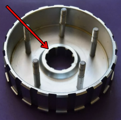

Re: 2 plate clutch centre.
I'm no expert on these but may have had a similar issue myself. If this (see pic) is what you are referring to, then I have done it myself.
- Attachments
- clutch centre.png (269.79 KiB) Viewed 8693 times
