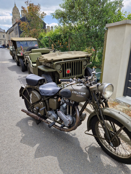

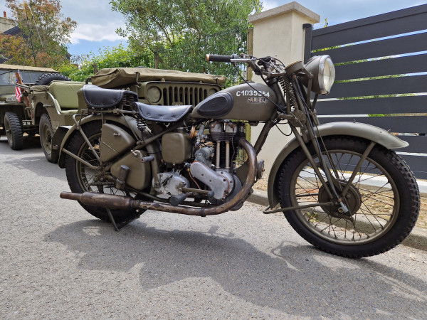

Hello all,
Last year in may I purchased something I had been looking for, for a while. I've had the dream to once own a WW2 vehicle and there is no better way to start then with a motorcycle. It's somewhat easy to transport and I own a space where I can peacefully work on it, on a ramp even.
To be fair I had no idea what I was getting in to. I've done my research, but when you've never really looked at a particular bike it's kinda hard to tell if parts are genuine or even belonging to the bike. I had some luck purchasing my Ariel. Not to expensive, at least I thought so. And pretty complete. Fully restorated in 2020 by three older guys, they owned more WW2 motorcycles. So I had confidence and bought my Ariel.
The frame is from a 1941 contract (frame number XG17219), the block is from an earlier contract I believe 1940 (BH3141) and the gearbox has number XICPBL28053.
It's been a year almost, full of adventures, a trip to Normandy, many many spark plugs and oil but mostly a load of fun. You can see it on the pictures, I bought it in the first week of may, and 4 weeks later we squeezed her in between our modern bikes on the trailer. I made a pillion seat on the rear rack, just so my girl could ride along if neccesary. Nothing original about that, but it was practical.
So far I've been quite busy sourcing parts and making it better. Lets say the so called restauration did not really meet my standards. A lot of things are poorly done. Simple things like leaking oil lines but also a wrongly fitted oil pump gasket (low oil pressure), lose main drive sprocket, wrong main front spring etc.

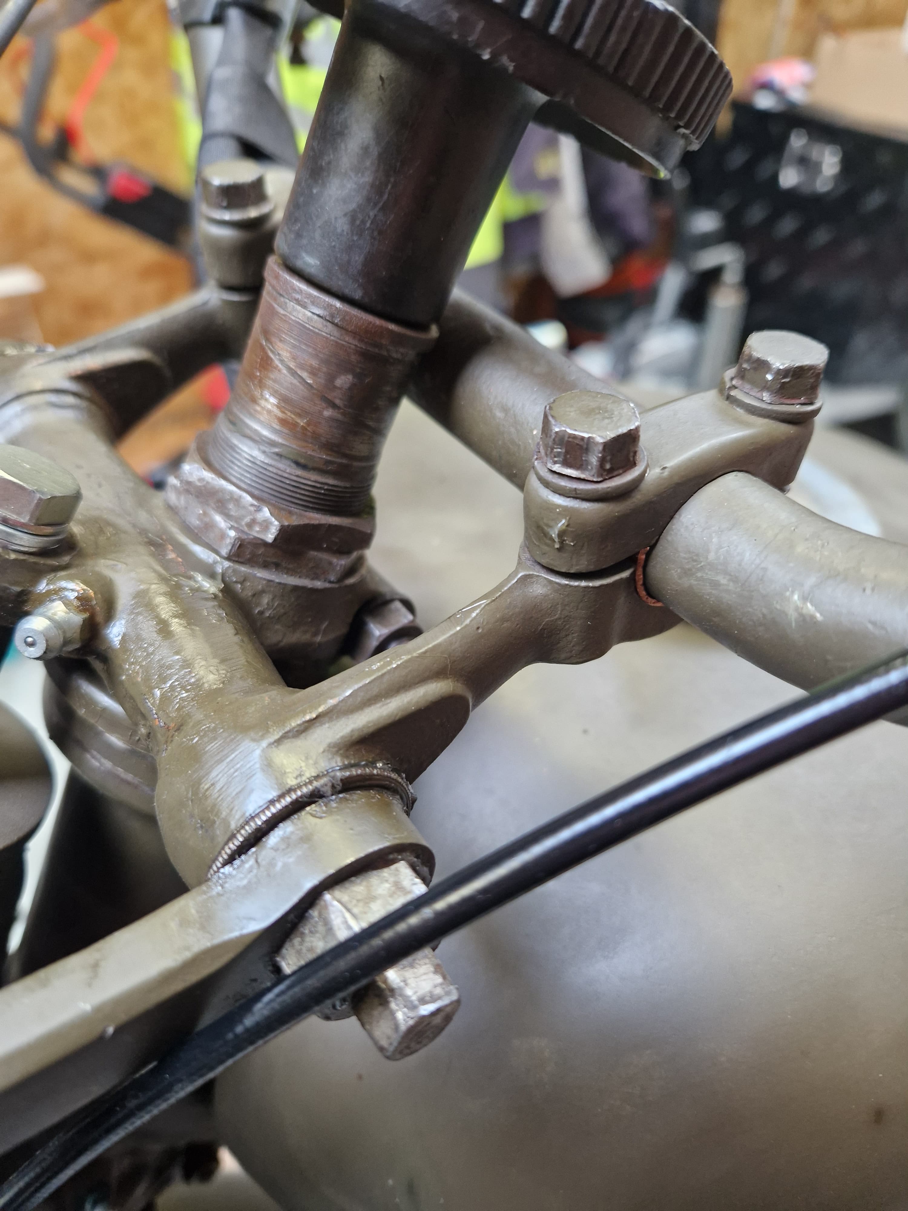

- I'm looking for a handlebar. Ofcourse I'd love to find a tapered one, but that somehow seems impossible. Right now I'm looking for a 7/8" bar with similar dimensons just to at least make it look better. Right now the bars are only 64cm wide, where its supposed to be around 74cm.

I wonder what you think about my Ariel. I really enjoy reading the forum here and hope to find out lots more about the bike.
Have a good day!

Your bike looks great Youri, and I'm glad you're enjoying it.
On the handlebars, I've got an idea that late in the war Ariel were using universal handlebars and fittings - these appear in the Orchard/Madden book if I recall correctly, and in a 1944 parts list I have showing standard controls from engine BH36402 onwards.
Maybe you don't need taper bars?
Re: New member 1941 Ariel W/NG
Thank you Simon! I really enjoy your blog by the way. I actually took quite some info from it before taking off my primary chaincase, it was very helpfull!simon.holyfield wrote: Thu Apr 24, 2025 9:48 am Your bike looks great Youri, and I'm glad you're enjoying it.
The yoke fitted on the girder fork is made to fit a 1 inch bar. The clamps on top are defintly not original or time correct in any case, but they are 22mm so 7/8 inch. So I filled up the gap in the yoke with two pieces of copper, made from regular copper pipe, that way I was able to clamp the bars properly without them turning. Ofcourse as a temporary fix untill I find a proper handlebar.
Originally I think this bike was fitted with the rubber mountings. But through it's life those must have been changed out for the top yoke without the rubber mount.

You are better off without the Rubber type Mounting. They frequently slip. The later bars have a split section between the Clamps, The Webmaster John Nash Had some made with the Bars way back. The tapered ones would be Hard to replicate. The Primary covers are not polished originally and are Painted. The original gearbox ratiios are trials type with a big jump to top gear. AS has been said later they used common parts across makes. Seats, handle bars. Is you headlight the right size? The glass should be flat. Remove the Oil tank and clean it out thoroughly. Grease the speedo drive gears and make sure they mesh fully. All that is EXPENSIVE so look after it. I've had 3 of them and I've done about 18.000 miles on one like yours. Nev

Thanks for your reply Nev! Good tips!nevhunter wrote: Fri Apr 25, 2025 1:28 am You are better off without the Rubber type Mounting. They frequently slip. The later bars have a split section between the Clamps, The Webmaster John Nash Had some made with the Bars way back. The tapered ones would be Hard to replicate. The Primary covers are not polished originally and are Painted. The original gearbox ratiios are trials type with a big jump to top gear. AS has been said later they used common parts across makes. Seats, handle bars. Is you headlight the right size? The glass should be flat. Remove the Oil tank and clean it out thoroughly. Grease the speedo drive gears and make sure they mesh fully. All that is EXPENSIVE so look after it. I've had 3 of them and I've done about 18.000 miles on one like yours. Nev

I used a bit of 25mm brass tube with 1.5mm wall thickness cut with a hacksaw. The attached picture is of these on a late war WNG yoke and they work very effectively.

That looks great. I'm going to look into that, thank you!Pete.Silson wrote: Fri Apr 25, 2025 9:06 am I used a bit of 25mm brass tube with 1.5mm wall thickness cut with a hacksaw. The attached picture is of these on a late war WNG yoke and they work very effectively.
