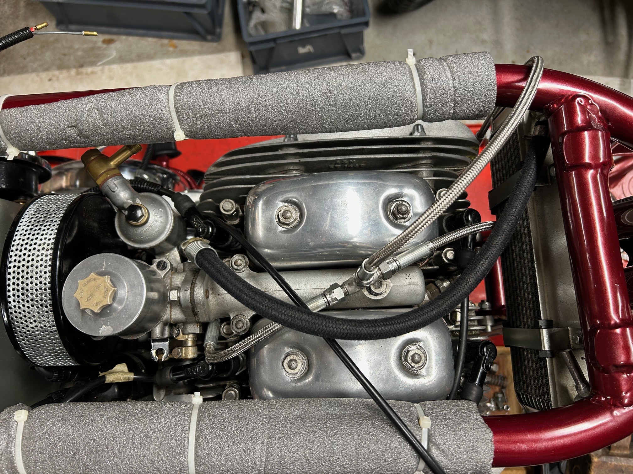

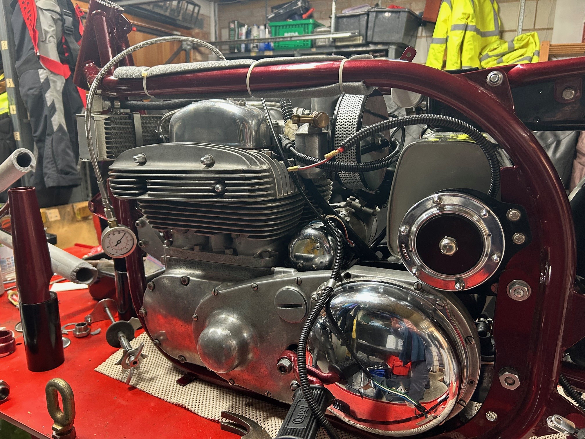

I now have the engine gearbox and clutch assembly back together and squeezed back into the frame, now for the front suspension and refitting wheels. (Grimeca front Brake and Yamaha twin levers). I Know..... but hey, the Healey Brothers went here before me right?? this should be pretty straightforward (famous last words)
The upgraded 12v electrics and modern battery and ignition will all fit into place once I remake all the shocking bullet connectors that the blind builder before me did, but the configuration of the oil pipes (including a T160 Trident Oil Cooler and an oil filter from a Citroen) has left me a bit stumped as to what goes where on engine and gearbox.. (and Yes I've fitted a Morgo Oil Pump) . Oh and Some photos of where I'm up to are attached.

Do any of you wonderful Sq 4 owners have a sketch or anything I can use to correctly plumb up the beast, bearing in mind I need to rig up the oil cooler and oil filter into the same system. I really would be terribly grateful

Q2 How to plumb up the oil pipes? The feed to the engine goes into the inner pipe on the junction block which bolts onto the engine. Connect the outer pipe from the block to the oil filter and then connect the return from the oil filter to the return of the oil tank. As the oil tank is of Norton origin, I have no idea which connection on it is feed and which is return. You will notice I have omitted the connections to the oil cooler. I have done considerable mileages on two Healey 1000/4 s which have shown that an oil cooler is not necessary and may in fact be harmful by not letting the oil get warm enough. I once rode into Krakow in Poland with a roadside display showing a temperature of 36.5 degrees C, my wife on the pillion, 3 weeks worth of luggage in the panniers and the oil cooler disconnected. I will admit to stopping the engine whilst the lights changed but I had no overheating problems; hence why the oil cooler on my current Healey has pipes on it for show, but all the cooler does is to hold the petrol tank on. Healeys wisely fitted an oil thermostat to their bikes but it was an exceptional day indeed if the thermostat directed oil through the cooler.

Think I'll go with the oil cooler , but do intend to fit an oil pressure guage anyway. because I already have one.. . the oil temp gauge is another awesome addition..
