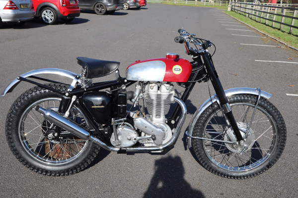

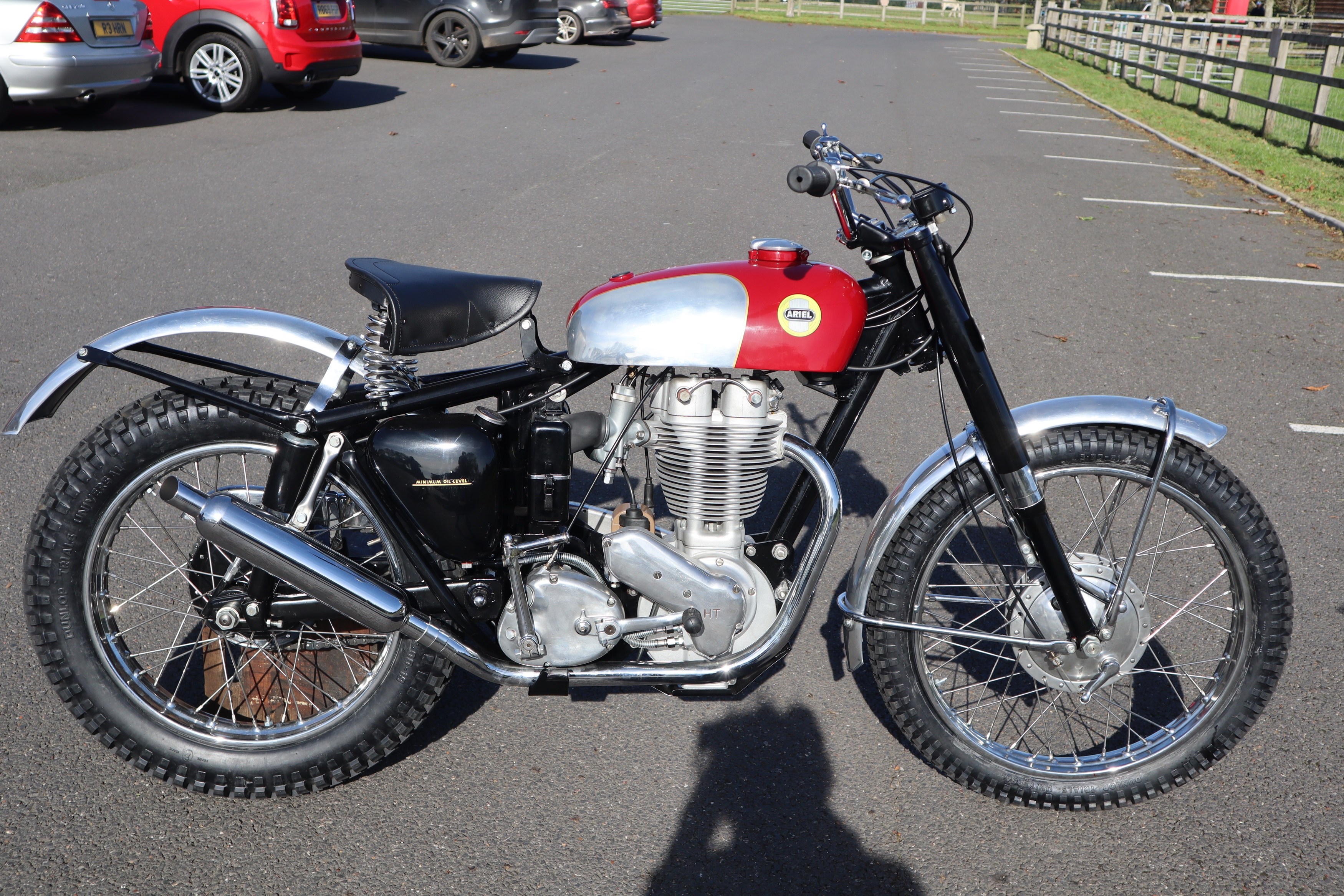

Sammy Miller recently restored a 1957 HT3, it appears on a couple of his YouTube videos. It sold at Bonhams last November for £7300 hammer price.
Sammy says: We have just restored this Ariel HT3 in our restoration workshop, all done by our expert Jim Devereux. The whole bike has been restored regardless of cost and surely must be one of the best HT3s in the world. The bike came to us with the registration number ‘677 AJH’ but unfortunately no paperwork. When we bought the bike it was 100% original and not modified in any way. We decided to do a total restoration as you would never find a 100% original competition Ariel HT3 again.”
This has a full width hub up front and this photo shows a fulcrum adjuster so an Ariel brake and forks??
Don Morley's 'Classic British Trials Bikes' book has a chapter on the HT's including a few period photos including his own HT3. They all have a full width front hubs. He does detail the fitting of BSA heavyweight forks and yokes (42-5010 top and 42-5012 bottom with head bearings 65-5126 and 65-5127) which are 5/8 narrower than the Ariel setup but this means the Ariel hub wont fit (unless modified as Will's post) and requires the 7* BSA single sided brake. He says this was the setup on the HT prototypes.
The factory sales leaflet for the Ht's shows a full width hub
There is also a YouTube video which is also on the otter site, where John Bartram shows what is what on an original HT frame. In that he says the headstock is a B series BSA item ?
