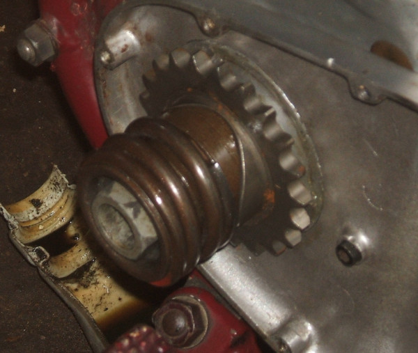

I need some help with my recently-acquired KH which is a bitsa
with a 1953 engine in a 1955 swinging arm frame.
I dismantled the primary drive to investigate the action of the
engine shaft shock absorber and discovered that the engine sprocket
and the clutch sprocket are some 1/8" or more out of line with the
engine sprocket being further out than the clutch. As best I can
tell the shafts are parallel.
The primary chaincases are the earlier, pre-FERC cases as I would
expect and the gearbox mainshaft is also the appropriate short shaft.
The clutch centre and chainwheel are also what I would expect.
This leads me to suspect the issue is somewhere within the shock absorber,
twin shock absorbers being something that I have no real experience of.
The sleeve is 55.3mm long and seems to butt up against the inner of the
main bearing while the outer end overhangs the end of the crankshaft
by 1.5mm. The outer face of the sprocket, a pattern part, is 15.7mm from
the crankcase wall measured at the root of the teeth.
Suggestions anyone?

That shock absorber spring looks to be very compressed, are you sure the sprocket is correct for your engine?
Regards Mick

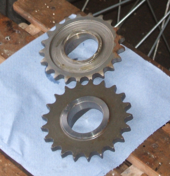

The arrival of an engine sprocket from the club's spares - thanks Rob - confirmed my suspicions
that, contrary to what others may have me believe, FH sprockets are not the same as KH sprockets.
KH sprocket on top - note recess in face and smaller flange
The new sprocket and a more suitable slider from my collection of parts - thanks for the hint Simon -
have sorted both the primary chain alignment problem and the almost-coilbound shock absorber spring.
With the shock absorber set up as it was there was a maximum movement of three teeth. With the new
parts this is now eight teeth. Moreover, the sprocket which was at least 3/16" too far out is now
where it should be and lines up properly with the clutch chainwheel.

With a new primary chain and replacing the six chainwheel set bolts that were there with the proper
bolts with a suitable shank to engage with the rebates in the chainwheel - thanks Acme Stainless -
I should be 'good to go'.
Thanks to all who offered advice.
