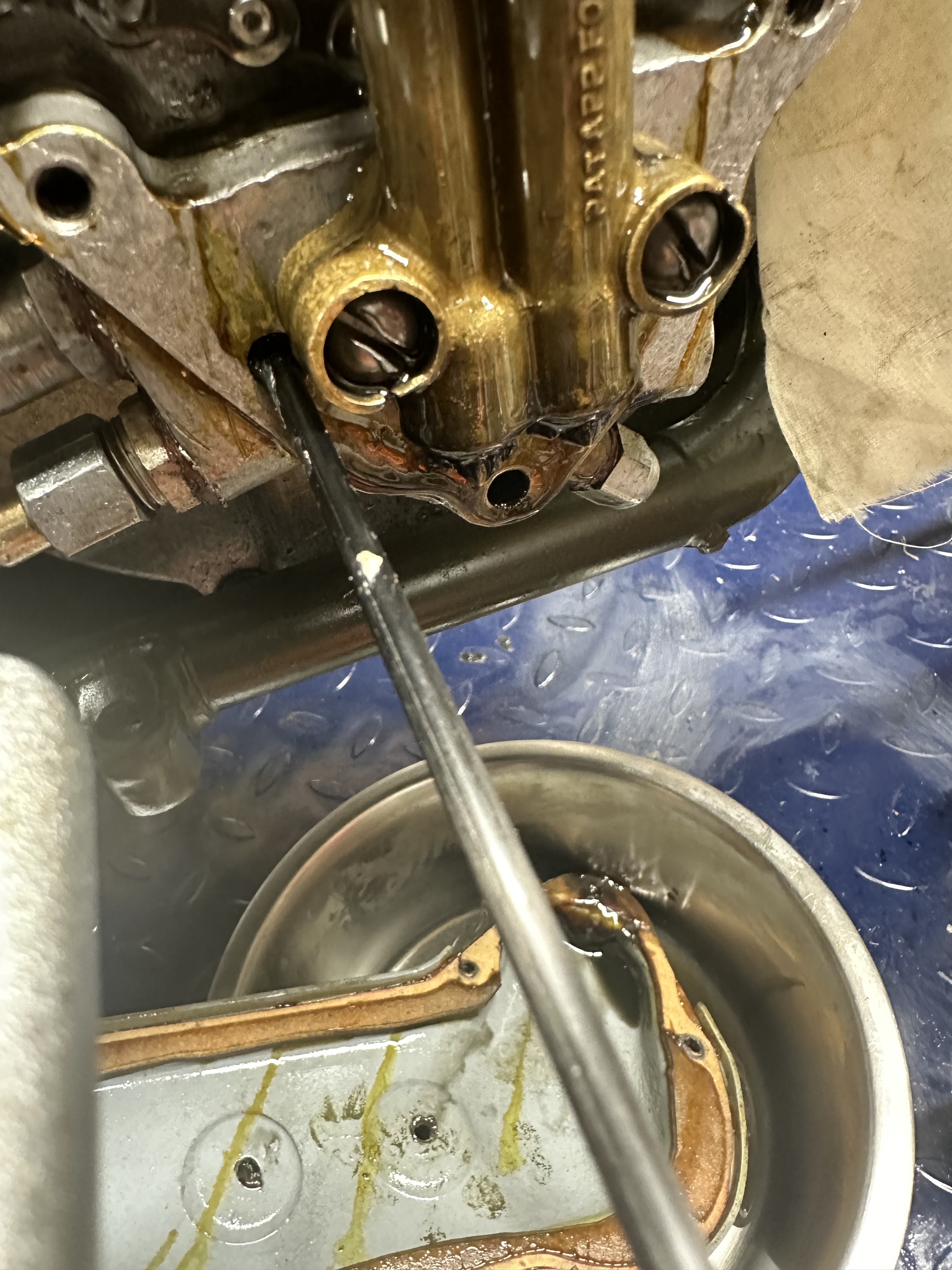

Slipped the timing cover off, and I have attached a picture which shows an oil way which may have been partially covered by the gasket Will. Its impossible to be 100% sure, but I am 75% sure it was at least 30% covered by the gasket.
I used a thick paper gasket, with wellseal and that stuff tends to run....
If the hole I have shown was partially obscured, do you think that would cause the issue?

I had a nagging doubt about the gasket and oil ways, which I ignored and forgot about Will. I think you may be onto something.

- Posts: 1200
Re: Lots of white smoke - W/NG
The hole to the left of the left side of the pump is the drain for the
timing case. I wouldn't think that drain being partially blocked would
cause oil to get into the combustion chamber.
