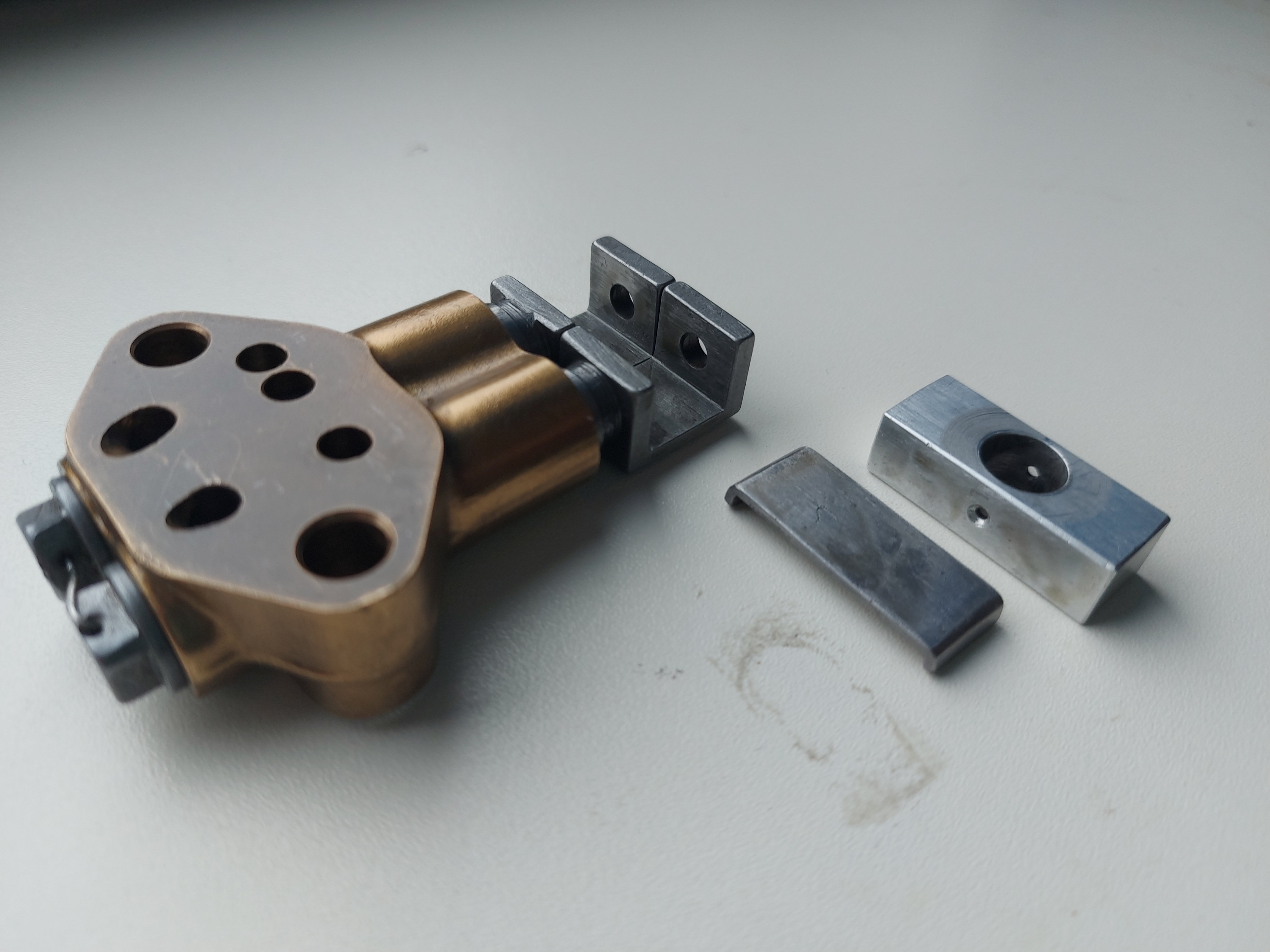

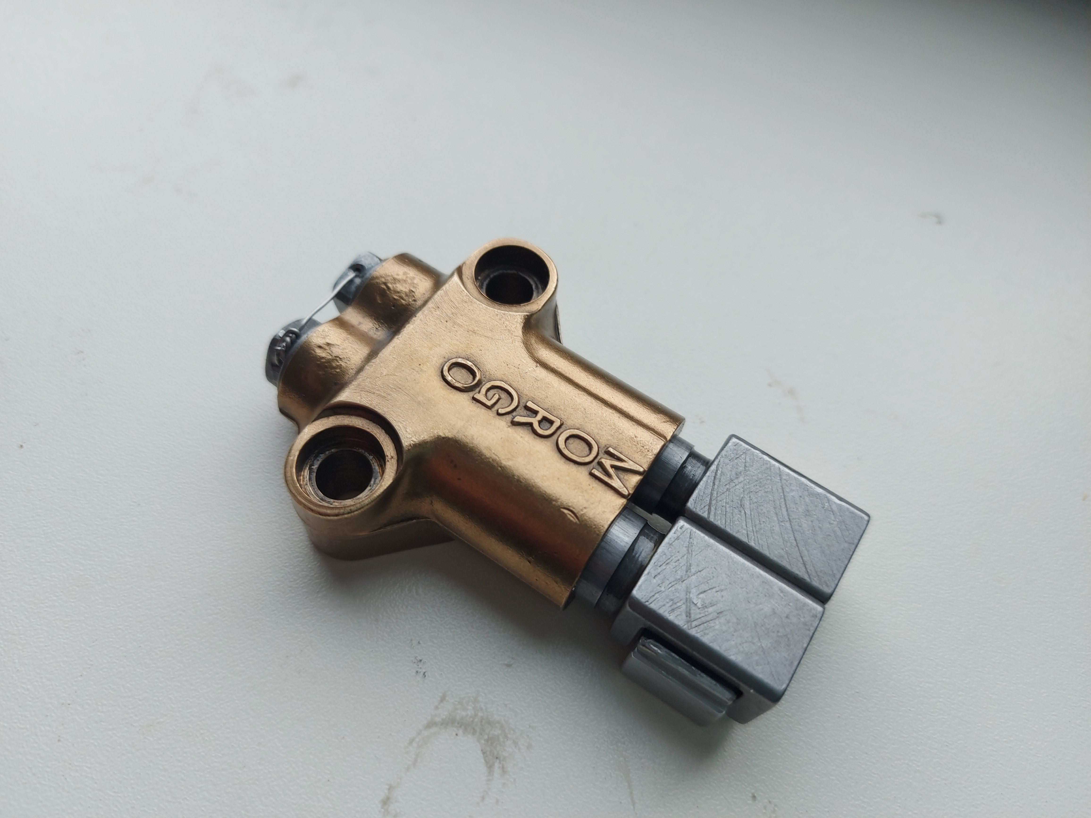

- Posts: 4870
Re: WN/G oil pump
A while ago I thought that increasing the pump volume would be a benefit.
I now know that to much oil just makes for a lot of drag within the bearings.
On a ball/roller bearing engine it works against it.
On engines with plain bearings it does make sense to get more flow/pressure.
Before that light went on
I modified a Triumph Morgo pump, bytheway, these have solid plungers.
see pics. the bronze body was shortened and plungers shortened to fit.
The two mounting holes need a tiny bit moving towards eachother.
Bottom holes needed a bit of relocating as you can see.
The (Triumph) Morgo pump has a thicker body because the plungers are larger in diameter.
So the 'hands' on top of the plungers sit away from the drive block on a Ariel.
I milled the mating surface lower but still had to make a shim/spacer to get the driving block to meet up with the excenter on the camshaft.
This spacer had two ears to prevent it from going awol.
So....nice try but useless
I think Morgo makes plunger pumps for Ariels, but with a lower capacity as those Triumph ones.
maybe someone knows if these 'new' Morgo Ariel pumps are any good ?
Still, any Ariel pump that still pumps is good enough for most.
Oh well, it makes a nice paperweight
dont use it......

- Posts: 5647
Re: WN/G oil pump
That's certainly going to pump too much oil. The drag comes from the flywheels running in it as the scavenge system can't handle the extra oil and the cases get really hot and the motor loses power from the oil drag of the flywheels. Racers found this out. Some use scrapers to help keep the oil near the pick up. Gravity is only one player in where the oil in motors ends up. You could sleeve the supply plunger hole. You can also shorten the plunger to reduce the amount, but that's something to be done carefully if at all. It's easy to think "More oil More better" but sometimes NO. I've had more trouble with my 50 VCH oiling than any other bike i've had. The biggest pump I tried was a Triumph one that is LESS than the morgo in flow. The quality looks good on the morgo. Maybe I'll put one on the KH . Nev
