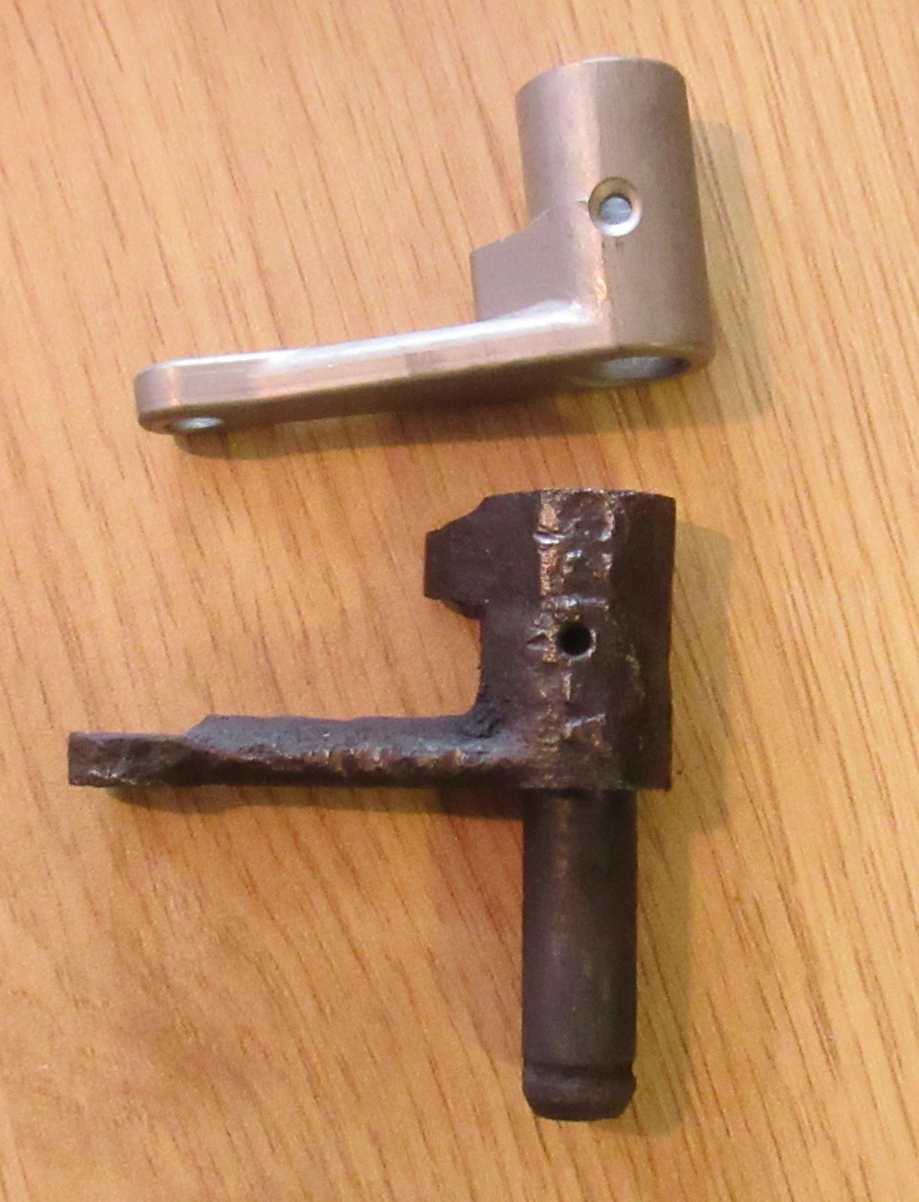

Rod, had rumage and found the non-E version that came with the bike but it is in a poor way. We have a works drawing available of the E version, copies available for £5. The non E version is the same but the cam is in a different position. Picture shows the E at the top

Hi Rod, the drawings are a club thing, not Draganfly although they shared the cost of digitizing them. The top one is the new one made by the last guy I sent the drawing to, the bottom one is old, rusty and wrong for my bike. See here http://www.arielownersmcc.com/members_o ... awings.htm you will need to log in.
