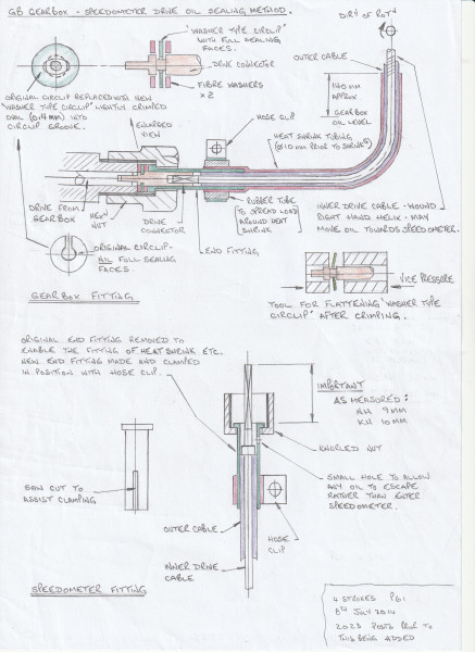

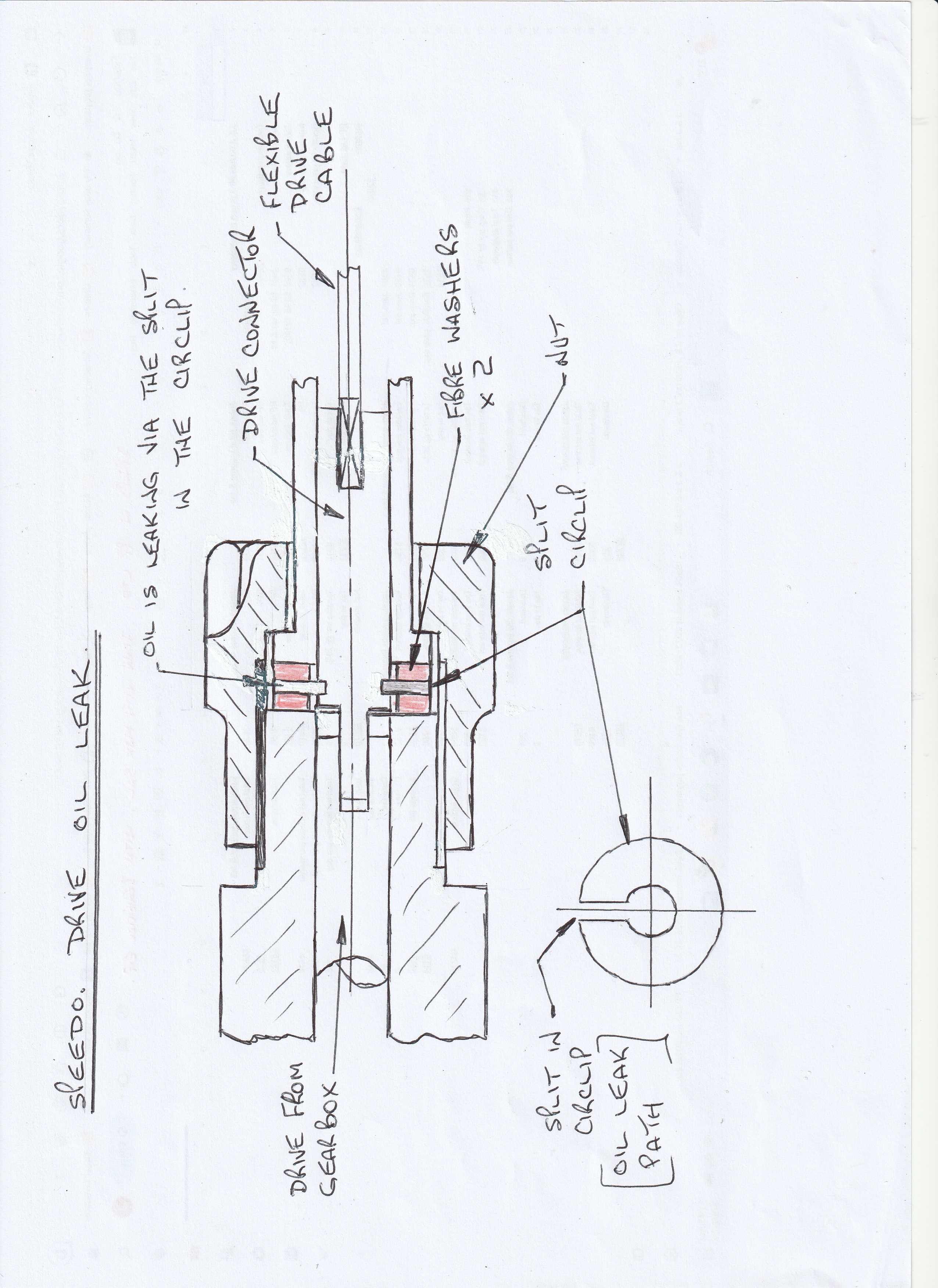

Re: Oil dripping from speedo cable
I had a similar problem, I found that one oil leak was due to the "split circlip" that holds the drive connector to the gear box drive, the oil leaks via the split in the circlip, I fixed the problem by making and fitting a non split circlip that had full sealing faces.
The other leak was via the damaged outer cover of the speedo cable, this I cured by fitting heat shrink,.
See attached sketches.
Hope this helps,
John P.
Hope this helps,
John P.
