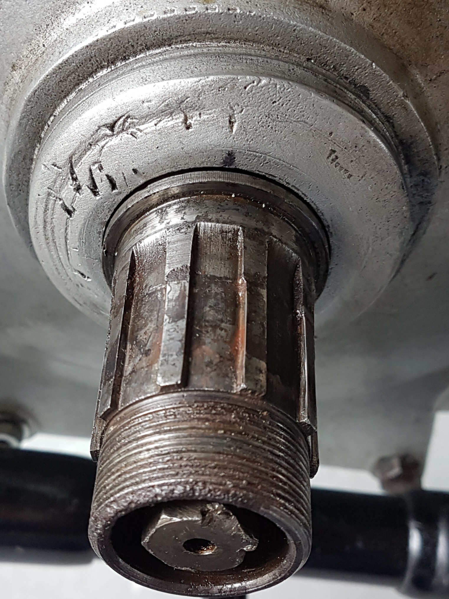

Hi folks,
This question is not about an Ariel, but I hope someone can help anyway: my 1929 BSA Sloper has a splined sleeve on the engine shaft with a thread that has 20 tpi. It is approximately 1.3" across the (94 year old, somewhat worn) threads. So my guess is 1 5/16th originally (?).
My question: given the relatively large diameter of this thread, is this still going to be a BCY thread (most of the bike is BCY) ? I haven't found any BCY thread charts that go up to that sort of size, but what else could it be ?
Cheers,
Bevan
ps
the obvious abuse the mainshaft nut has endured is not down to me !

IF it's 20 tpi it will be a British cycle. It has 26 tpi and 20 in whitworth form. Use plenty of good chain oil on the BSA slopers. I've had 3 of them. Nev

That size does exist, Bevan. 20tpi cycle (aka Whitform) threads are certainly used in that diameter. I have a 1926 AJS and 20tpi appears regularly on the larger diameters such as wheel spindles etc.

Thanks guys. Will see about trying to chase the threads.
- Posts: 5604
Re: A basic thread question
That part is super hard and often cracks on KEYWAY on the other end to the thread. I'd check that first before I spent time on it. The roughness is probably rust. A 32 tpi hacksaw blade with the SET ground off at the CORRECT degree angle would chase the THREADS OK

buy an imperial thread file, but make sure you use it in the right direction, very handy tool for cleaning up damaged threads.

The Part is too hard to file in my opinion. Check it's not cracked before you buy a thread file. It's already quite worn on the spines. Nev
