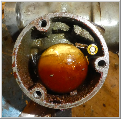

From your further observations it does sound like the contamination is fuel borne. I'd agree with the suggestion to decant some into a glass jar and see if it leaves a gummy residue when it evaporates, if it does I'd put it down to the tank liner leaching into the fuel. I don't line my tanks after cleaning for this very reason and don't suffer any issues with gumming or water, (keeping the tank near to full whenever possible).
Photos of my FH carb and ex tank liner during restoration:
Regards Mick

I guess you used the chain instead of a collection of nuts & bolts? Good idea!
