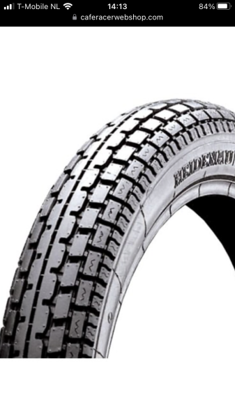

I can’t say anything about the rideability of Roadriders but I trust Avon does not make bad tyres at all. However the looks of the Roadrunner is another point! In my opinion they look far to modern on a classic bike. Overhere in Holland there are quite some Ariel riders who drive on Heidenau K34 tyres, and cover realy serious numbers of km’s/miles in wet and dry conditions with no complaints at all. The Heidenau K34 tyre does fit the classic looks of a Brit Bike in my opinion…
