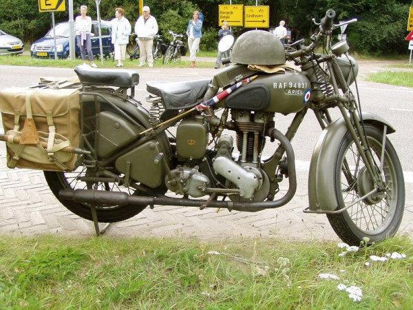

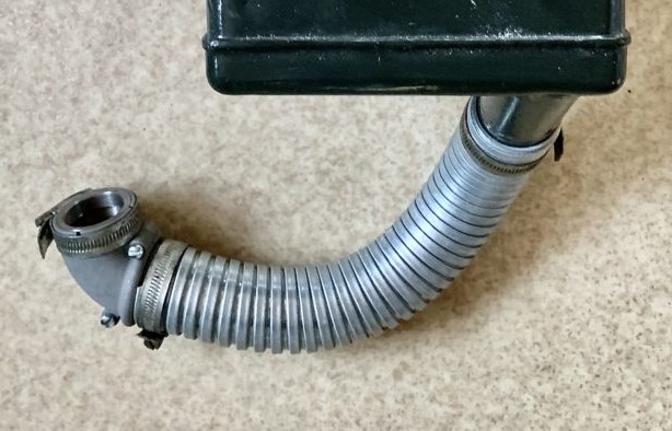

The Amal has a threaded adapter ring smooth on the outside.
Smooth part fits in a two halves elbow piece, and then a short tube that fits in a short metal flexible tube.
maybe pictures below show ?
The elbows are the same across all WD models only the lenght of the tube varies (as far as I am aware...)
Repro elbow are made in the Netherlands (elbow piece + flex tube) ask about this on the WD forum (BSA M20 forum)
