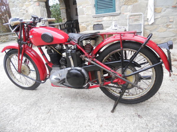

Looks right to me! Compare with pic in Simon H's post yesterday here
http://forum.arielownersmcc.com/viewtop ... 47&t=13160
- Posts: 5147
Re: Help with rear brake plate/cam
This is about the best pic I have of the rear brake
