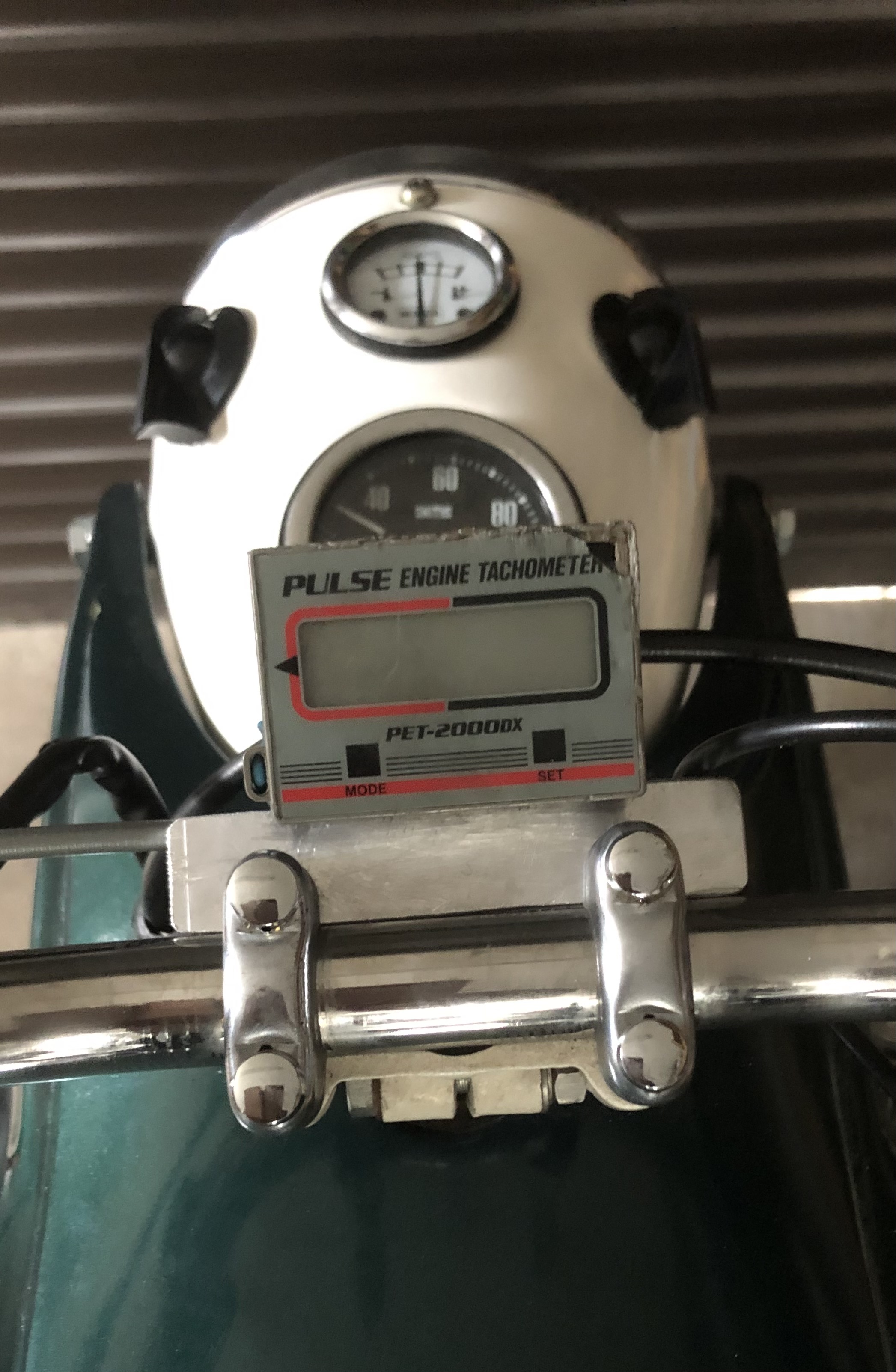

I mounted a very cheap tacho which detects ignition pulses, this shows 6500rpm revs at Wide Open Throttle, Pic attached.

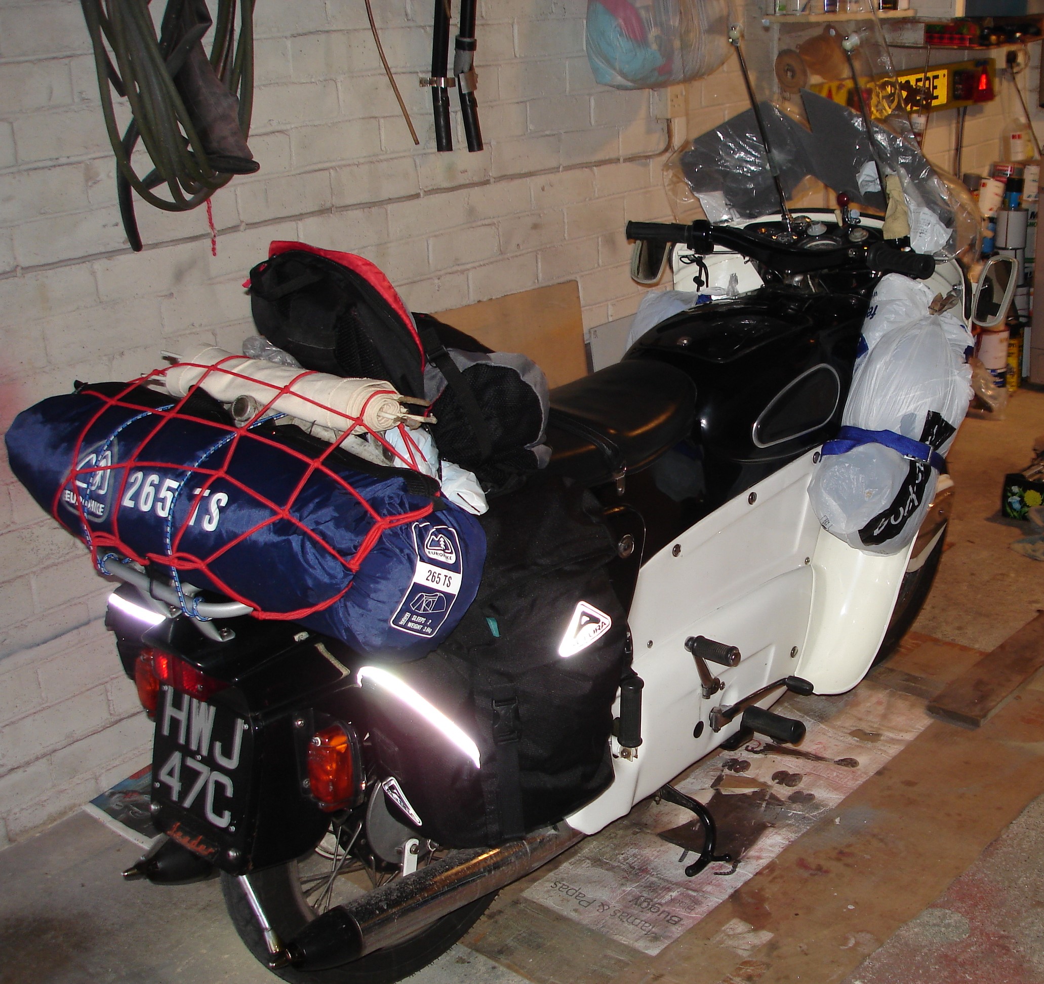

The heavier Leader pulls well up most hills even with camping equipment ,using standard gearing, although this bike does have a 376 carb.

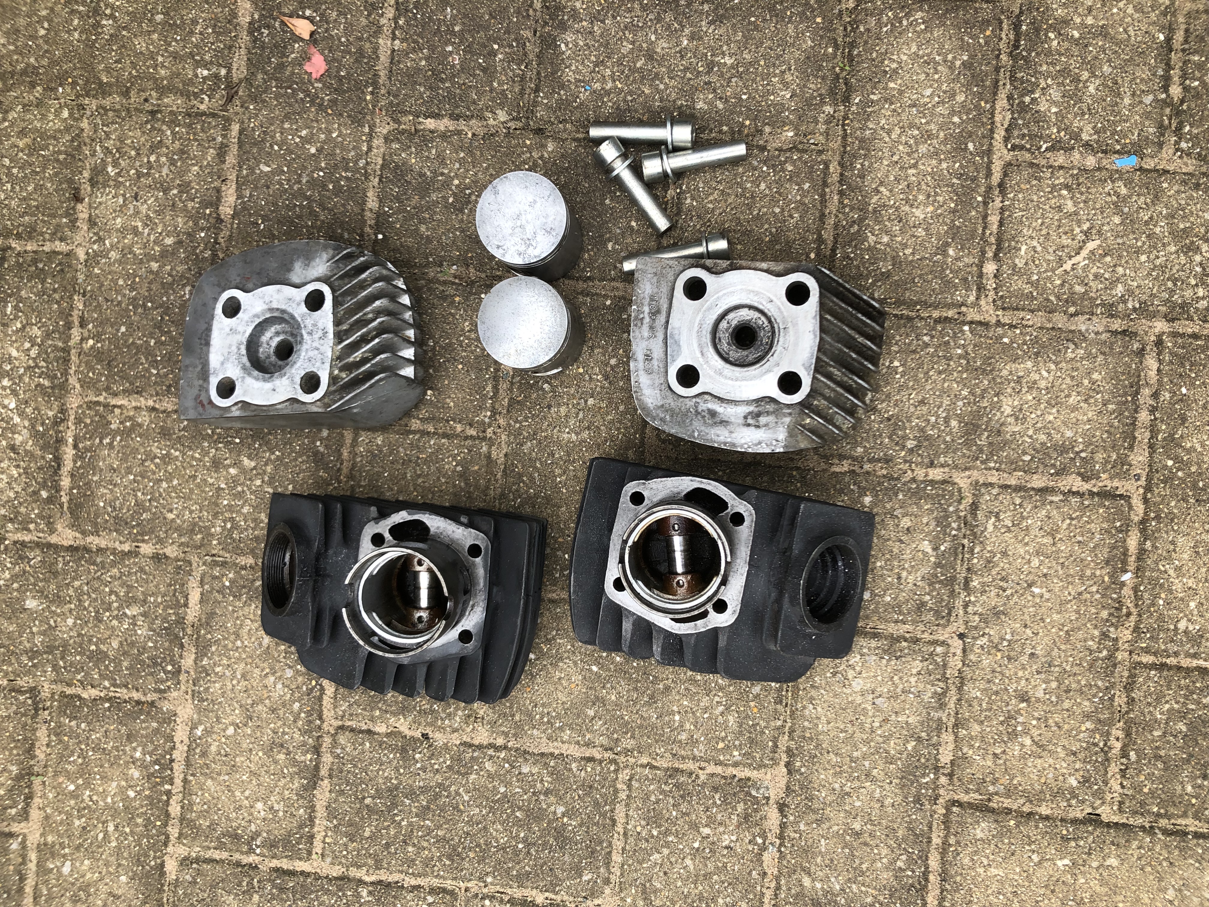

I do have a spare set of cases, barrels heads etc, and over the winter I will be building up a spare tuned engine. Lucky, the inlet port is larger in the cases, as it is from a later engine. The Barrels etc are going to be ported but for torque rather than revs, as it will only ever be used on the road.
I have just purchased a set of really nice barrels with original pistons and another set of original pistons +30 thou, with rings etc. 2 heads, 1 being from a 200cc machine. All on Fleabay for £150 delivered.
