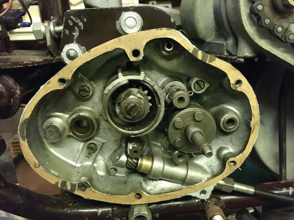

i have a 500 single and the clutch chainwheel wont line up with the engine sprocket its as though the clutch needs to go in more about a 1/4 inch also which way should the cam assembly face ie; where should the three pegs on it be to line up with the quadrant

Some photos of the engine shaft with the sprocket in place and the gearbox mainshaft would be
helpful. Also there will be a number on the gearbox - something like GB40 or maybe GB45 - and
a date code - like C57 which also might help.

hi Will the numbers on the gearbox are GB40 then either R or K 56
