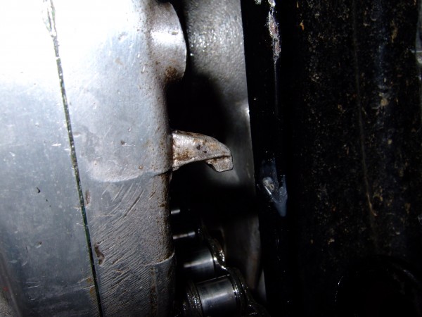

Right then. It does appear that I have a rear chain oiler - well a sort of grooved spout coming from the inside of the inner chaincase which presumably dribbles oil on top of the drive chain below - see attached photo. Thank you Roger!
However, I cannot see any signs of a screw, just a small hole through the inner chaincase. I think this is the culprit, as oil seemed to be around that vicinity - since cleaned up - and I can see it flinging off onto the rear wheel. Not sure why that should be the case especially if the chaincase did not seem full of oil, but I think I will block up the hole regardless. I keep the the drive chain well lubed up manually in any case.

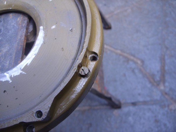

Here's a pic of the adjusting screw.
There is a 'trough' inside the case which collects oil 'flung' off the primary chain. This trough communicates, via a hole in the rear chain case, to the 'trough' in your photo. The tapered end of the adjusting screw alters how much oil comes through that hole. If you screw it right in it should block the hole.
Alan
Alan
Re: VB chaincase oil leak
Alan
Yes indeed - many thanks. However, this screw was screwed right in, so perhaps I am wrong in my assumption that it the oil feed spout that is causing the trouble. I cannot see much on the inner face of the inner half of the crankcase either. No obvious oil deposits. I think I'll just have to give it a run and take another look if I obtain an oily wheel again. As Johnny mentions, gearbox sprocket seal could be a factor. No idea if it is OK or not though....
