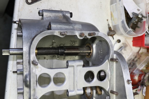

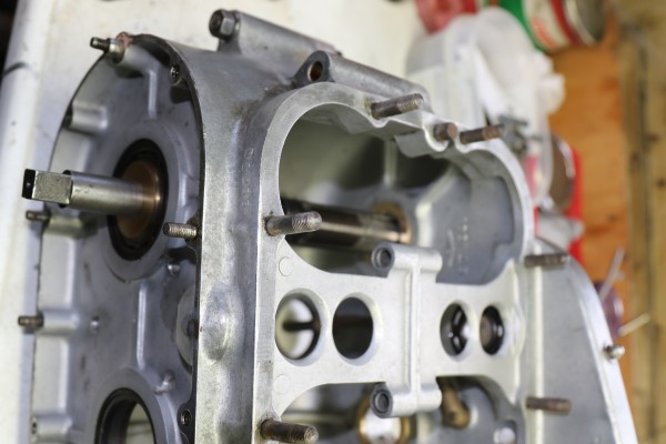

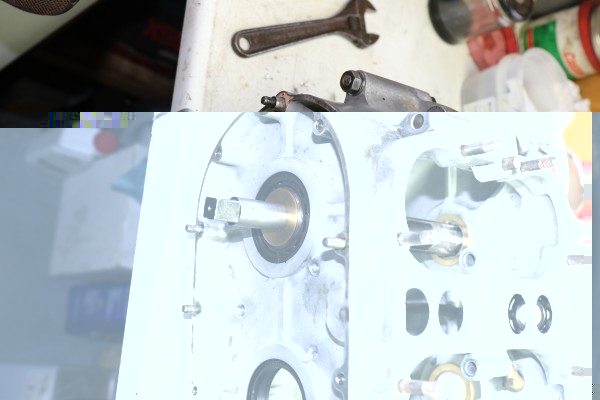

I thought you might be interested to see my approach to line boring the timing side mains. It uses the same principles as your but arguably from the opposite approach!

Nice to see those photos Paul...and that adjustable reamer looks like a good quality one rather than the rather poorly made Indian ones...
Is that a domed nut on the top of the timing chest? Is that instead of the rivet for the fibre rubbing strip? Just about to replace my strip, so quite interested....

Yes Paul, the fibre rubbing strip on this engine is held on with screws and dome headed nuts. The owner is someone who likes his bikes to be individual rather than standard. I replaced the fibre rubbing strip on my own engine using the time honoured method of rivets but you do need a second person to assist in the task. It worked out OK though. If your tensioner for the timing chain cannot slip, you don't need the fibre rubbing strip. Ariel didn't fit one to the Mk I or early Mk II.
