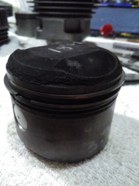

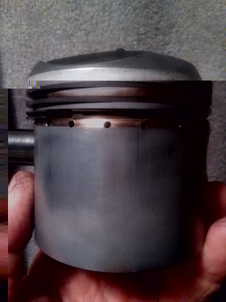

The engine has standard VH cam and followers, 7:1 com and it goes like stink....!
The vibration it had with the old piston has gone.
Two pics of the old piston attached
I have the ignition timing and carburation spot on, and have no worries about piston seizure it feels free and I enjoy doing big throttle roll on's

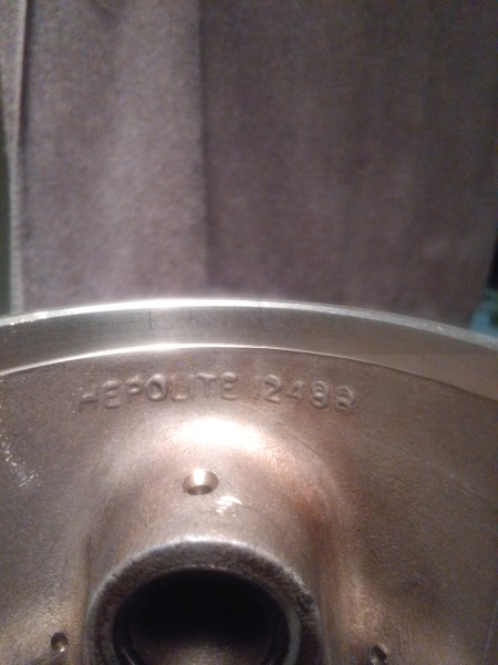

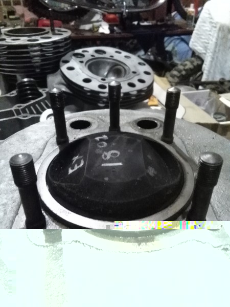

Very low hour 1956 HS MK 1 piston, @ .020" over.
The complete weight is 480 g
