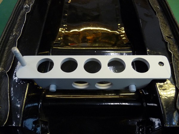

Steve Clarke asked about the mod I made to make removal of the dualseat easier, here a explanation with some pictures.
(I vaguely remember to have mailed this before, but perhaps not on this forum?)
Pic 1. shows bridge piece on frame , left hand bolt is welded to bridge and sticks into toolbox, right hand one ends just above oiltank.
this bridge stays fixed to the frame, and second bit of angle iron fits into it.
Pic 2. shows the other bridge piece attached to the underside of the seat, it has two horizontally pegs pointing to the front of the bike.
these pegs fall into corresponding holes in the bridge piece on the frame.
Pic 3. shows them near eachother, the red arrows give the direction they move into eachother.
Pic 4. shows them together, it's best to use angle iron that has a 90 degree inside, most angle irons have a radius on the inside, it's possible to use that type but you have to give the outer angle on the other bit a curve then (ehhhhh obvious ???)
Hope this explaines it a bit !
The seat has raised a small amout because of the thickness of the two angle irons on eachother, therefore I made two small 'blocks' at the rear mounting points to have the plot level again.
In my case I had the make these blocks off-set as the seatbase holes did not line up with the frame points.
Seat is hold by two M8 bolts at the rear, undo these and slide the seat about 2cm back and it comes of.
Oh bytheway.....it was alot of work!
regards , Vincent
