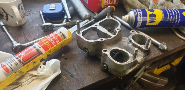

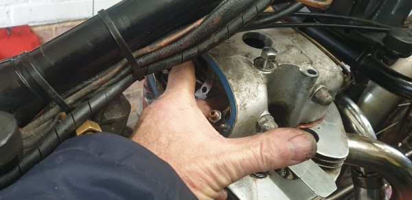

Refitting my rockerbox, I use just a smidgen of super high temp cheap builders silicone on my re-used copper gaskets
Careful gynecological manipulation of the push rods.
Finally back on

ni Steven i the spread the silicone on the caskets and let it dry a bit before fitting and tightening them up , if you fit
it straight away with the silicone still wet it pushes the silicone to the outer edges of the gasket , and the silicone is just sealing the outer edges of what you are fitting , if you take of something that has been fitted without letting it dry you will see that there is no silicone on the faces or gasket :!:
Steven.Carter
Posts: 4311
Post by Steven.Carter »
I just kind of wet the gasket with the silicone, almost nothing left so it dries very quick.
