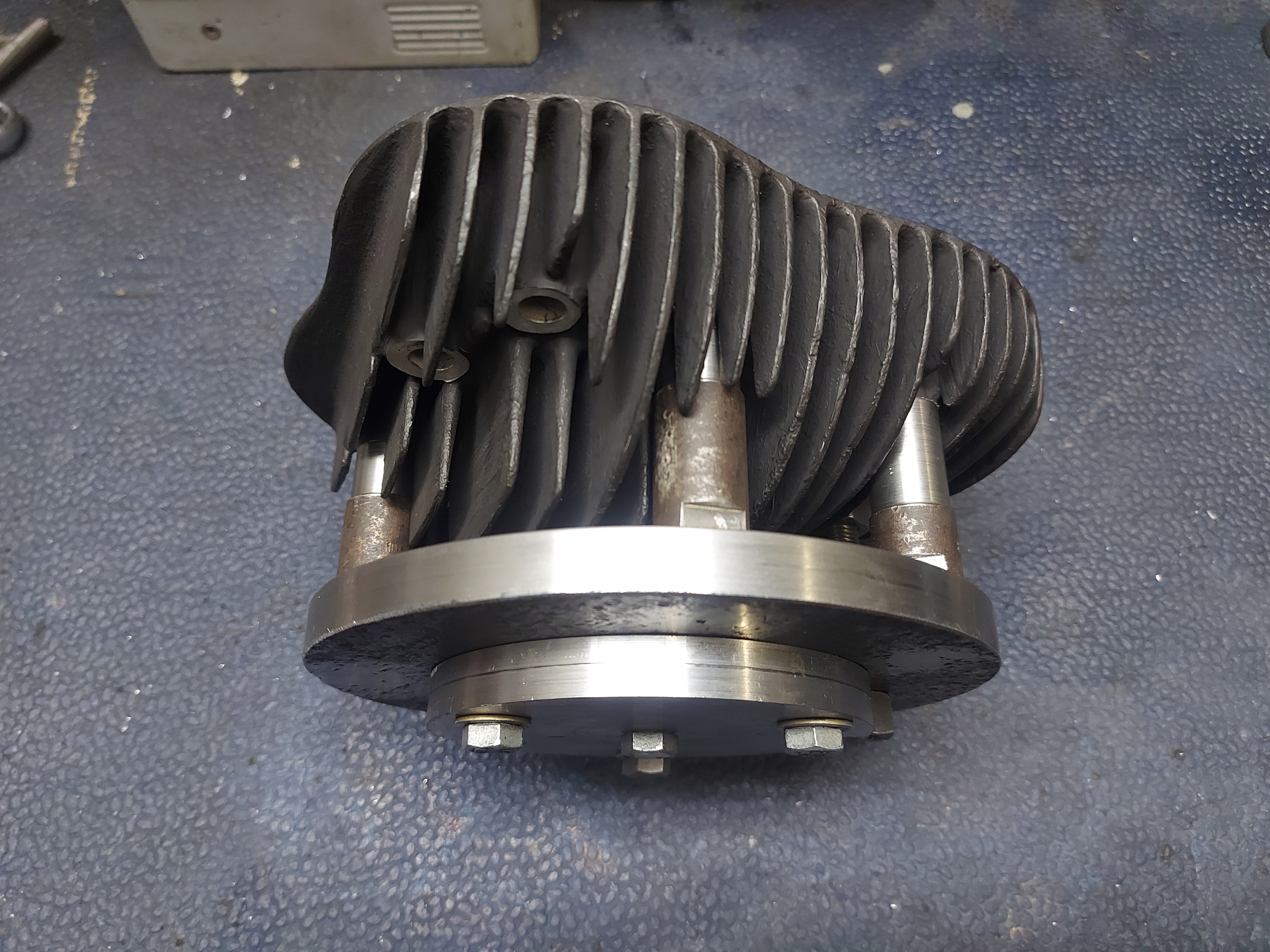

Wanting to skim the cylinderhead.
And who knows.....maybe upp the compression a tiny bit ?
Not for my lathe as that has not enough swing as seen here :
( I have two cylinderheads, above is the 'dummy' one.)
I made up a jig :) .
Lot of work for just a one time use....I must be bonkers :lol:
The cylinderhead is supported level by 4 studs that stick into four of the nine cylinderhead bolt holes.
And held with one bolt through the sparkplug hole and another in the (threaded) TDC hole.
The way I use to do things..... van dik hout zaagt men planken :lol:

I like that.
Dedication to the cause.

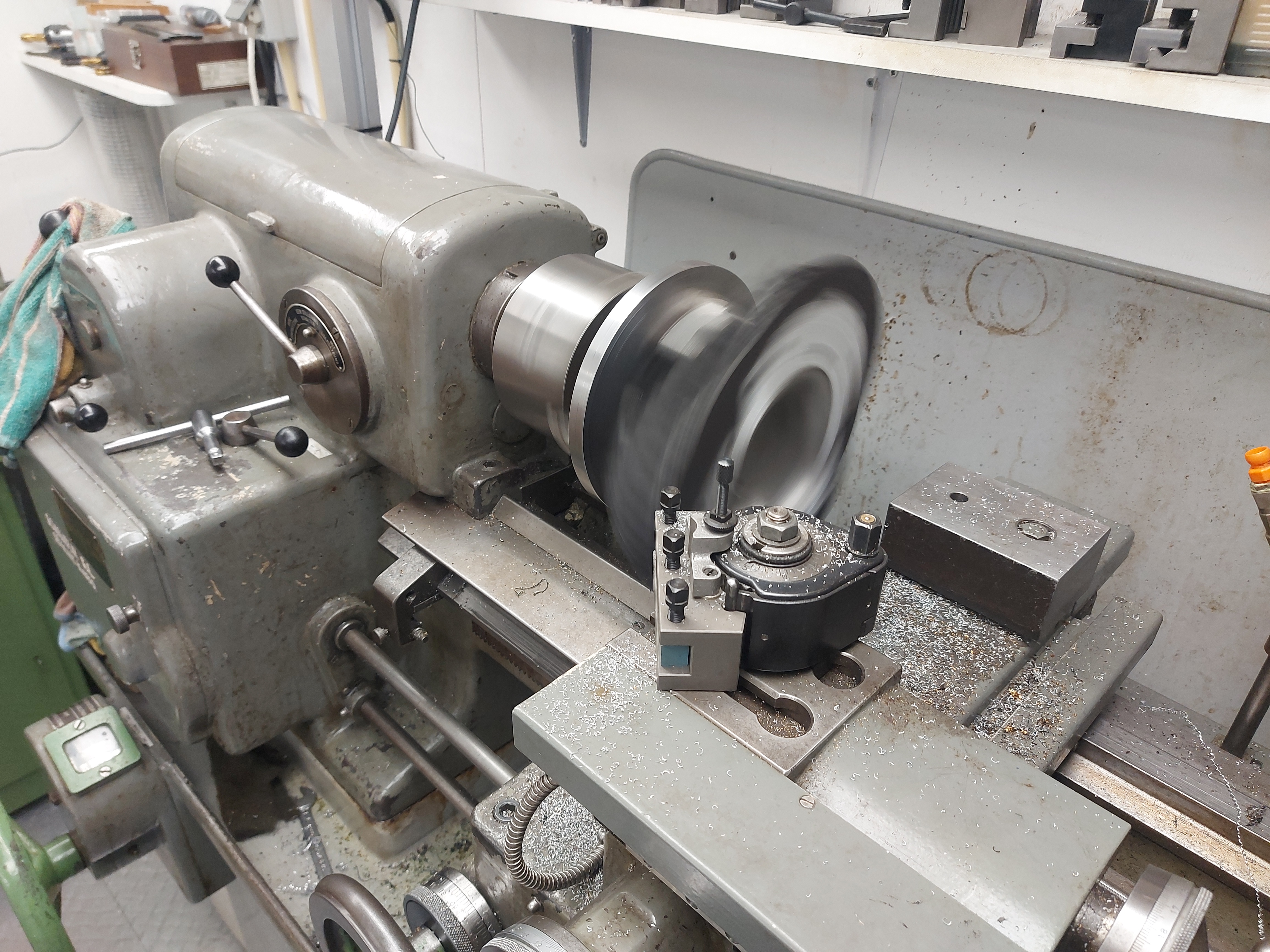

Skimmed the VB head on a nice Schaublin lathe.

Looking great!
Bob.Murphy
Posts: 1216
Re: VB build
Post by Bob.Murphy »
Nice lathe 8-)

Posts: 4885
Re: VB build
Thanks !
