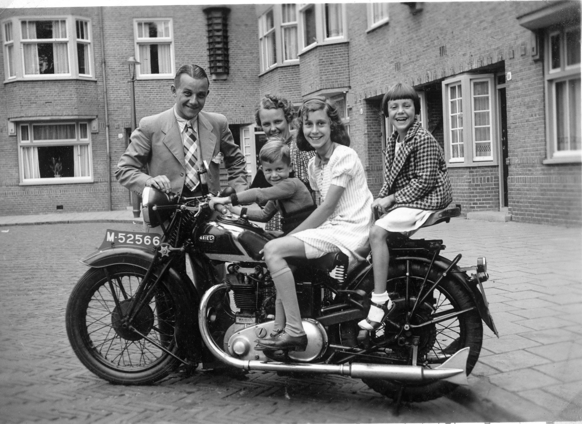

This is the only period picture I have showing a 1937 model.
But it does show the knee grip position, hope this helps.
But you have the later type of kneegrips....
- Posts: 4891
Re: 1937 VH Project
These look a bit like them : https://www.brooklands.it/articolo.asp?l=EN&ida=35278

Thanks Vincent!
I thought this is the previous version of knee grips used up to 1936.
Maybe the design of the tank is different? The one i have attached says 34-37 but I would say it is more like 34-36. If that’s the case then maybe i have to adjust the lines slightly.
