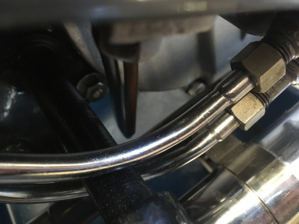

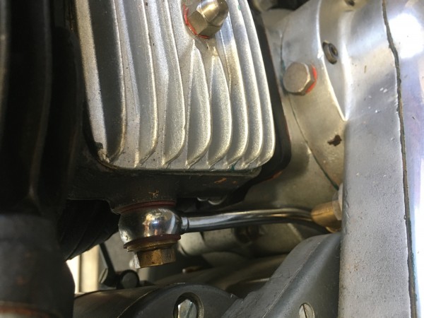

Fist pic showing my valve chest banjo connection.
Second pic showing both Valve Chest and timing case breather pipes exiting vertically down to just below the bottom frame cross member.
The shiny horizontal pipes in the foreground are oil out and return to the engine.[attachment Gary

It sort of dangles down and vents to the atmosphere.
