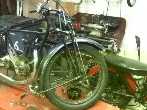

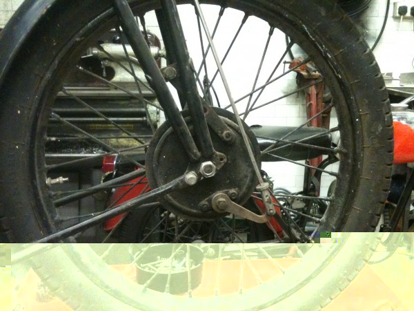

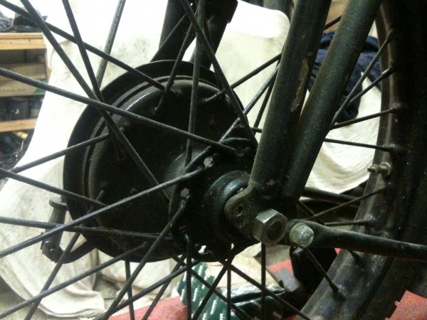

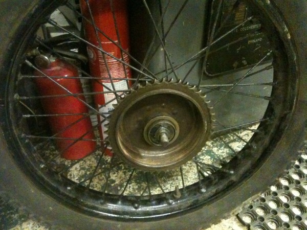

here are some pictures of the wheels fitted to my MF frame number B3732 believed to be 1932 drums are 5.5 inch 19" rims and half inch wheel spindles

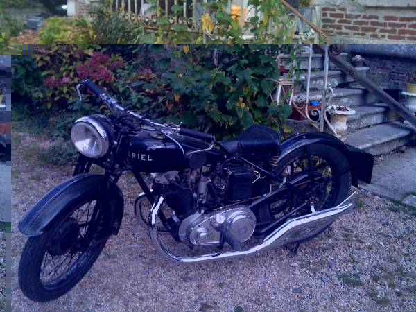

i'm an owner of a MF 31. I have donated on PDF the parts and the owners manual to this forum. Besides the wheels whom are 18" the primary gearbox is hard to find also the cross over for the brake(brake is on the righthand iso the left).There are about 500 MF's build. I have photo's from the brake drums. The webfork spring is also different and hard to find. I know someone in holland who let it made by a spring factory( copied the original).The opening in the tank is for the speedometer which was an option at that time. I have the original cover saying " fit smids speedometer in here" installed. At the time i bought it there was little internet and i had to find all info from everywhere. Mine is not "for the purists " a pure 31 or 32. I think it was at the change from 31 into 32. The first used all the old spares and mixed it with the later ones. When i started i had to find out everything from the manual and make copies out of that. But it's riding and that is what counts.
